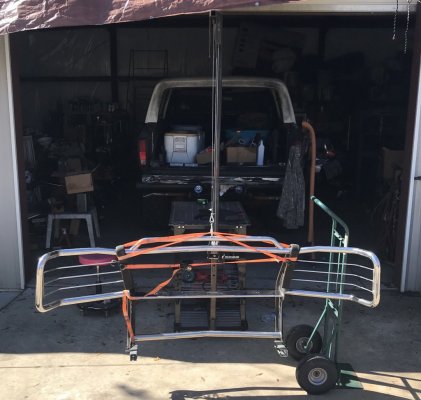

Hurt my back again, still have to get things done. So I added casters to a small welding table, then added a receiver to the bottom. Then added wire rack shelving. Now I can add a receiver hoist to lift and move stuff like bumpers around the shop. This should help me keep from aggravating this back.

Here is my intended use of the hoist on the welding table, help with holding an fitting bumpers and brush guards. Still may add some out riggers. It’s lighter and easier to move than an engine hoist, the table is great for add ons
