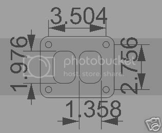

HX40....that's T4i...so either a Hypermax...or Carson Stauffer or Irate could build you one.
The dimensional mounting flange differences between a T4 and a T4i are miniscule...you can get away with "enlarging" the holes on the T4i exhaust housing to work on a T4 mount. Downpipe, and turbo compressor/intake plenum clearances, as well as oil supply & return would be points to consider when selecting a mount....but that's for any turbo. Be sure to post up and share what you're final solution is...help others along the way. There's a lot more readers than posters on these forums.
Great T4 vs T4i differences thread
http://powerstrokearmy.com/forums/showpost.php?p=53594&postcount=4
T4
T4i
