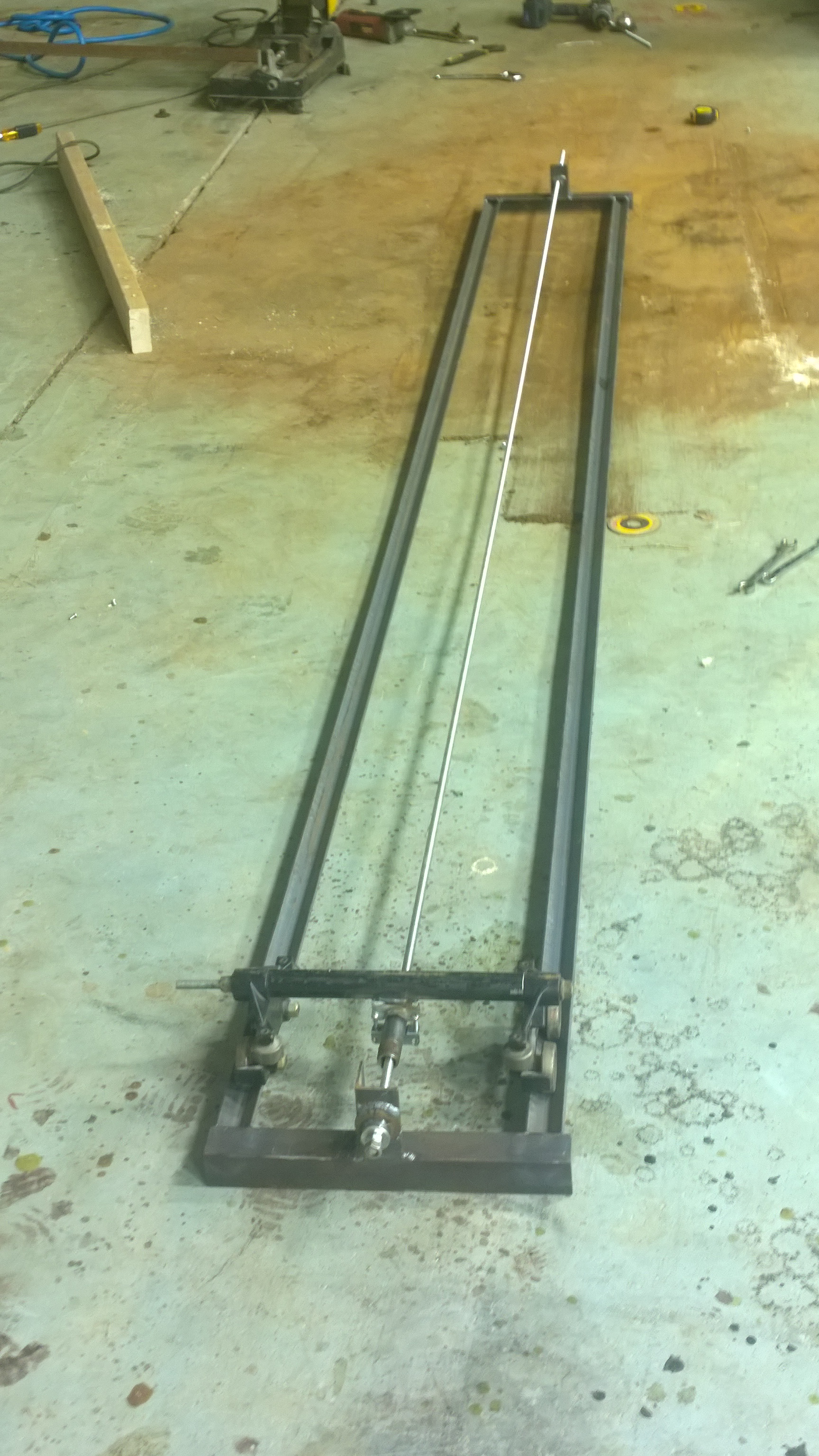

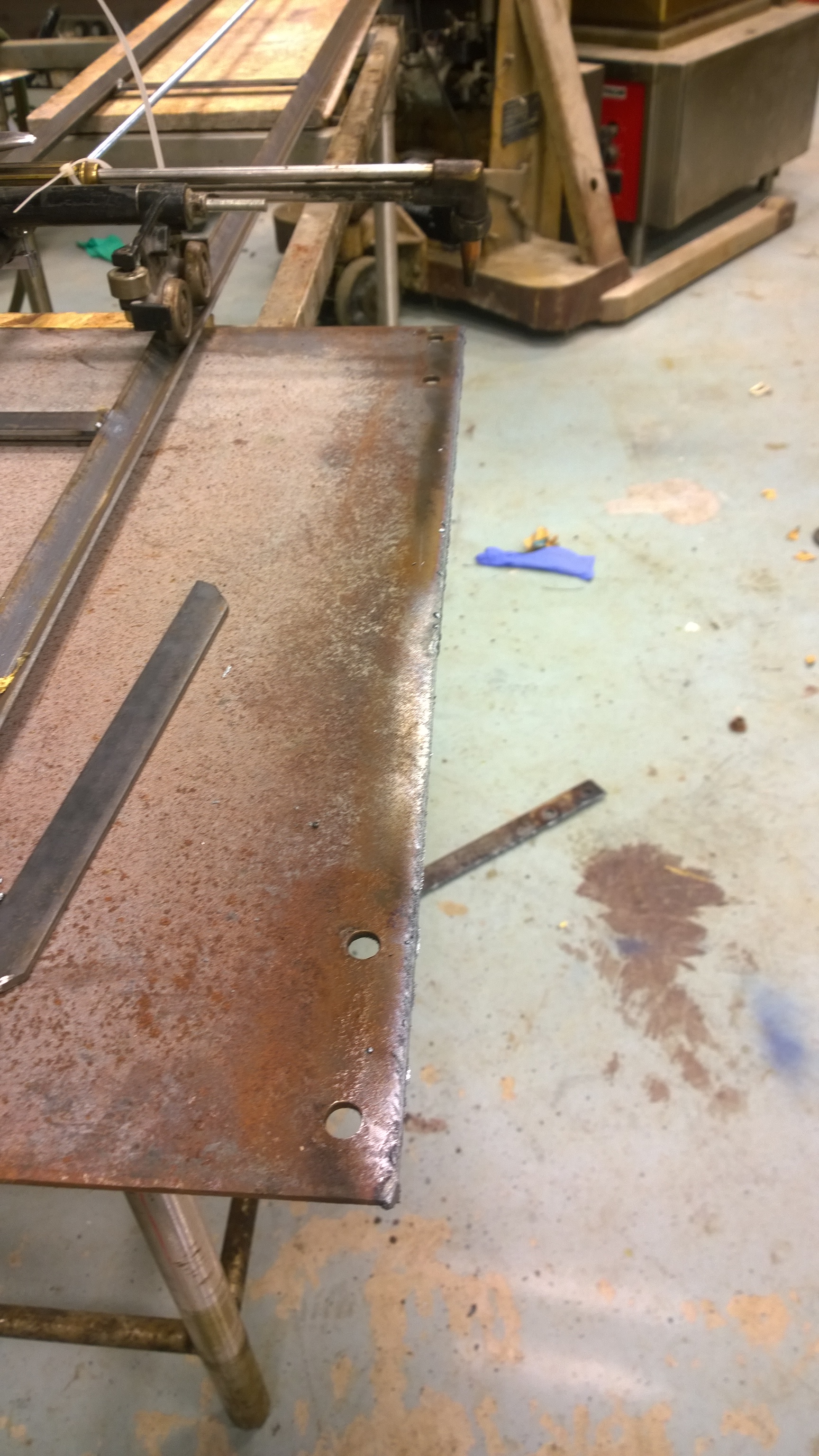

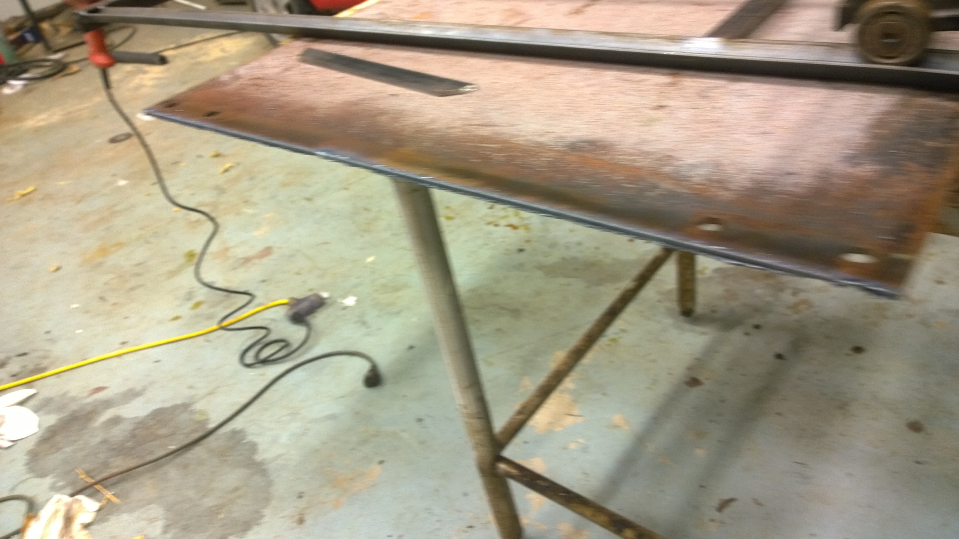

Couldn't sleep last night and it was raining so I started on this. Pretty simple. Its about half way finished. Still need to stouten up the tracks and build the mounts for the torch. Track is 10' long.

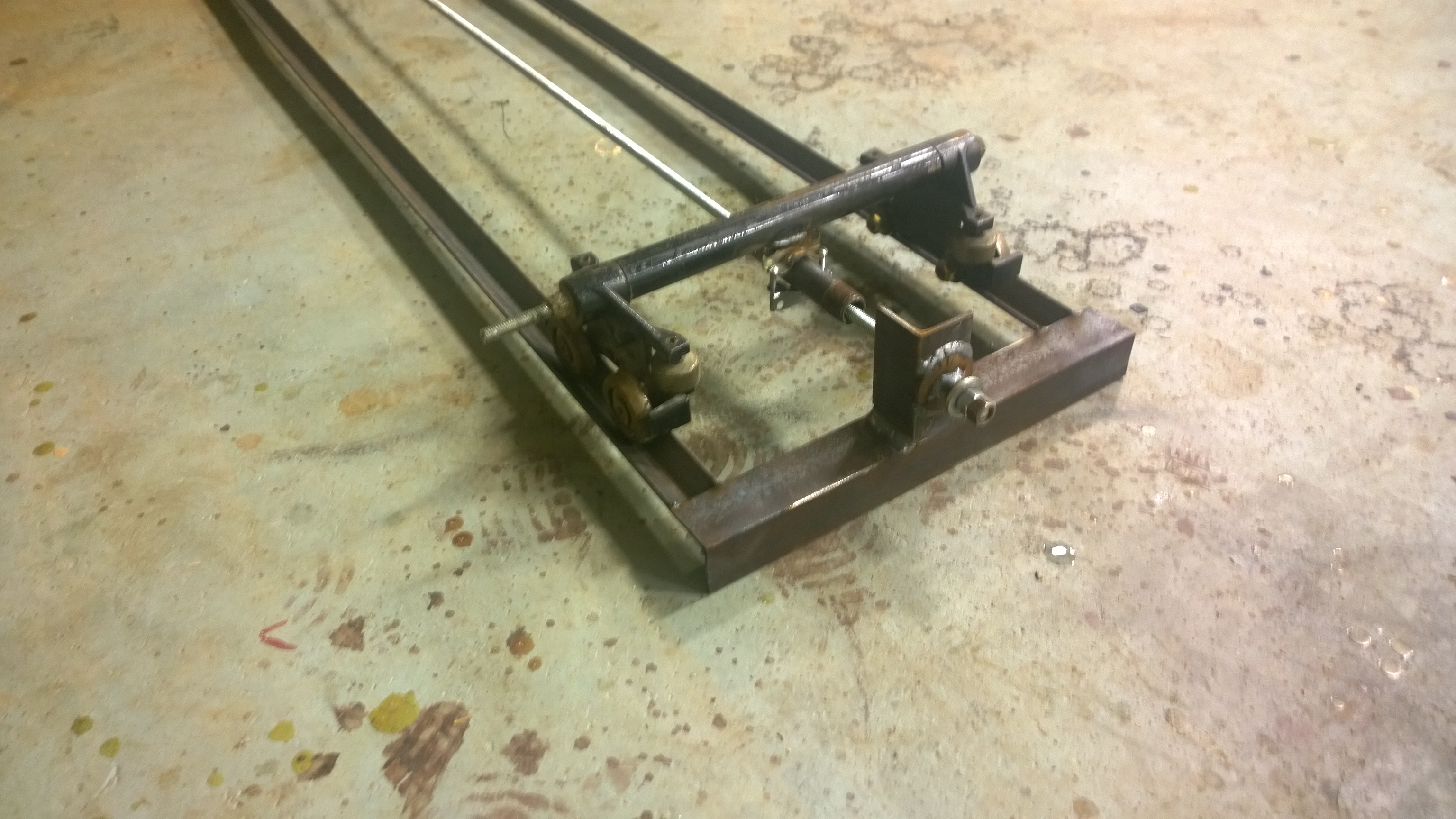

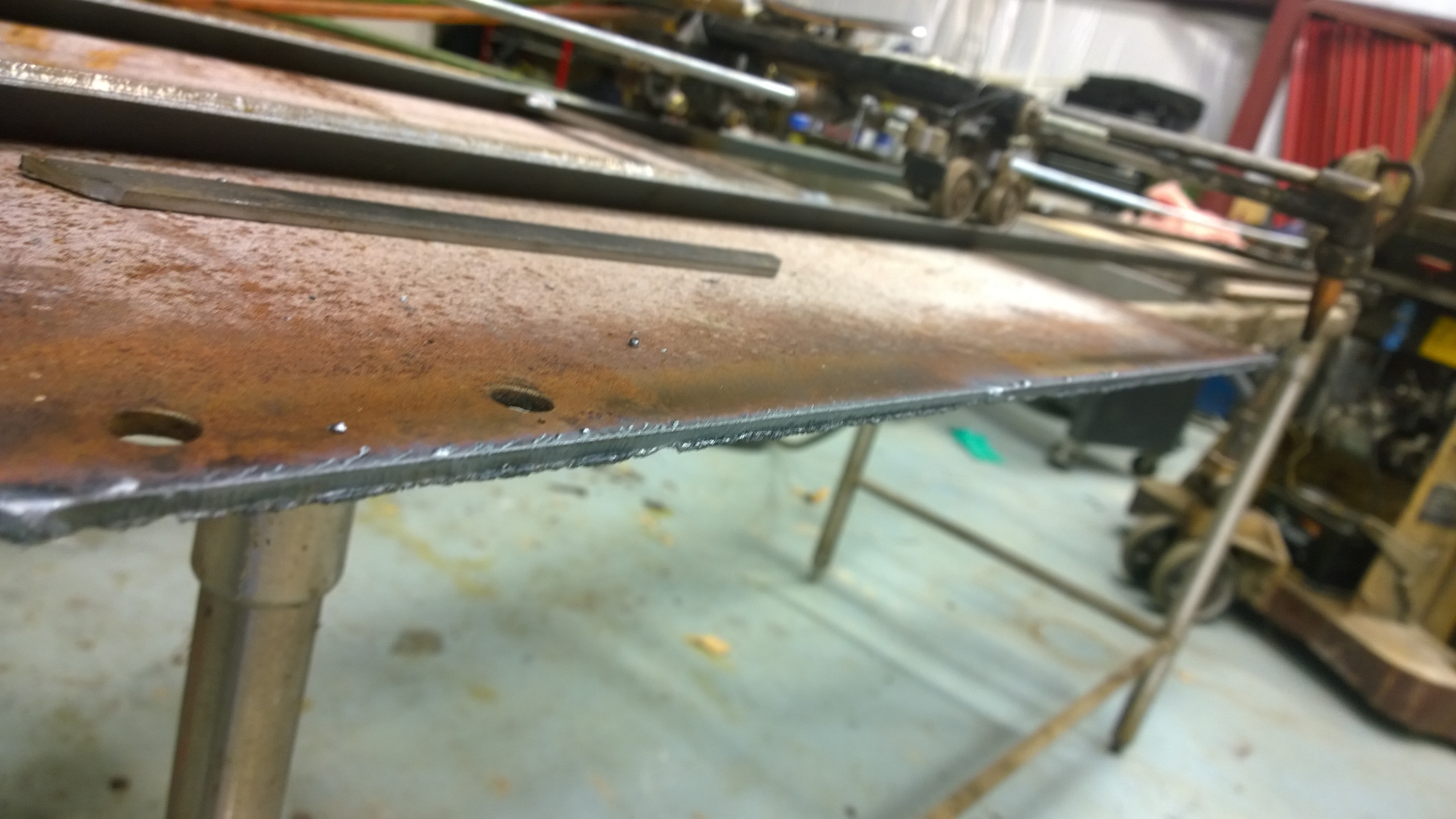

Made a rough test run. Pretty happy with the speed. Still needs some fine tuning
