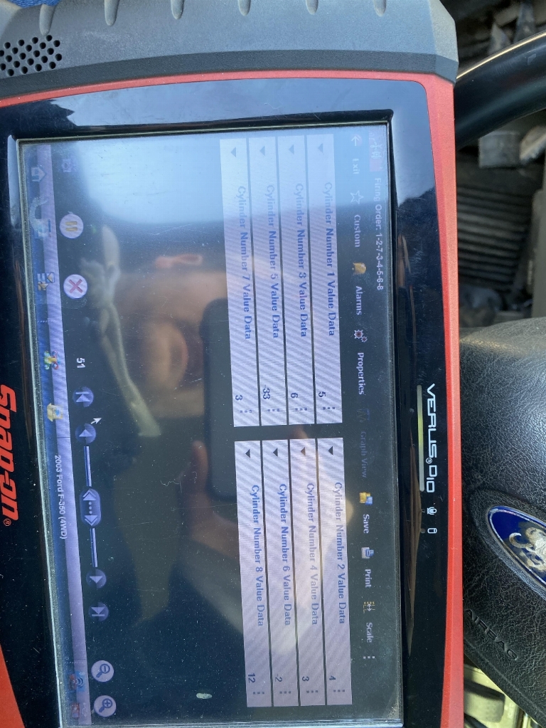

Ficm from a truck with a vgt issue (as it was described to me by another mechanic here) was out in.
Now the truck won’t idle, and it has the same issue the first truck does. Drove it (carefully) to my buddys and did a contribution test.
The way i read this I need two injectors, but i don’t know anything about how they read other than negative is bad.
But for the vgt issue, does the ficm control vgt? Run the vgt test and it looks like the vanes are staying at 50% and choking the truck out. MAP doesn’t change on the vgt test till 50-60 percent anyway. Unplug it and the truck revs up and idles.
That’s the same symptoms as the other truck apparently.
