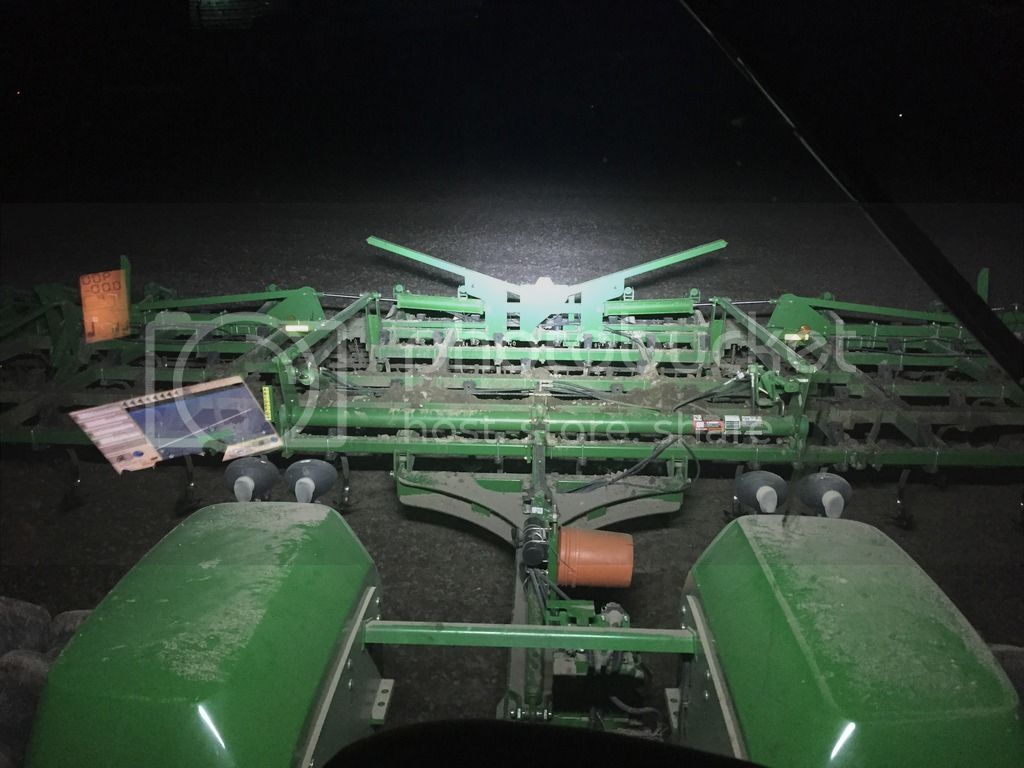

Lightbars only light up the dust. I had a 31" on the back of my tractor and as soon as the dust started flying I couldn't see the back half of the field cultivator.

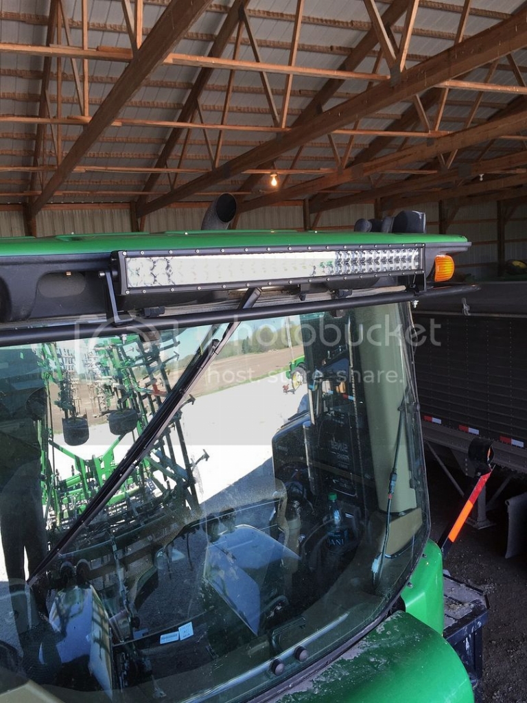

I believe the smaller the light the better. You can point the light is the direction you want and not have one big bar to where you can't direct the light where you want it.
This is where I had mine and the glare from it was terrible.
