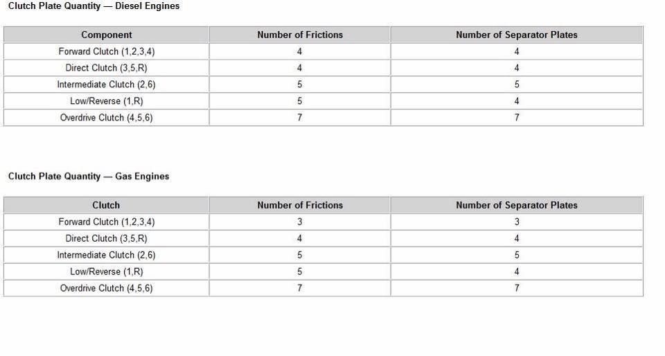

If you could find a good used one out of a 13 or 14, would there be an issues fitting it? Anyone know?

Would it be possible to pull the trans and add the extra clutches before damage happens? Is there room for the extra clutches or did they change everything?
