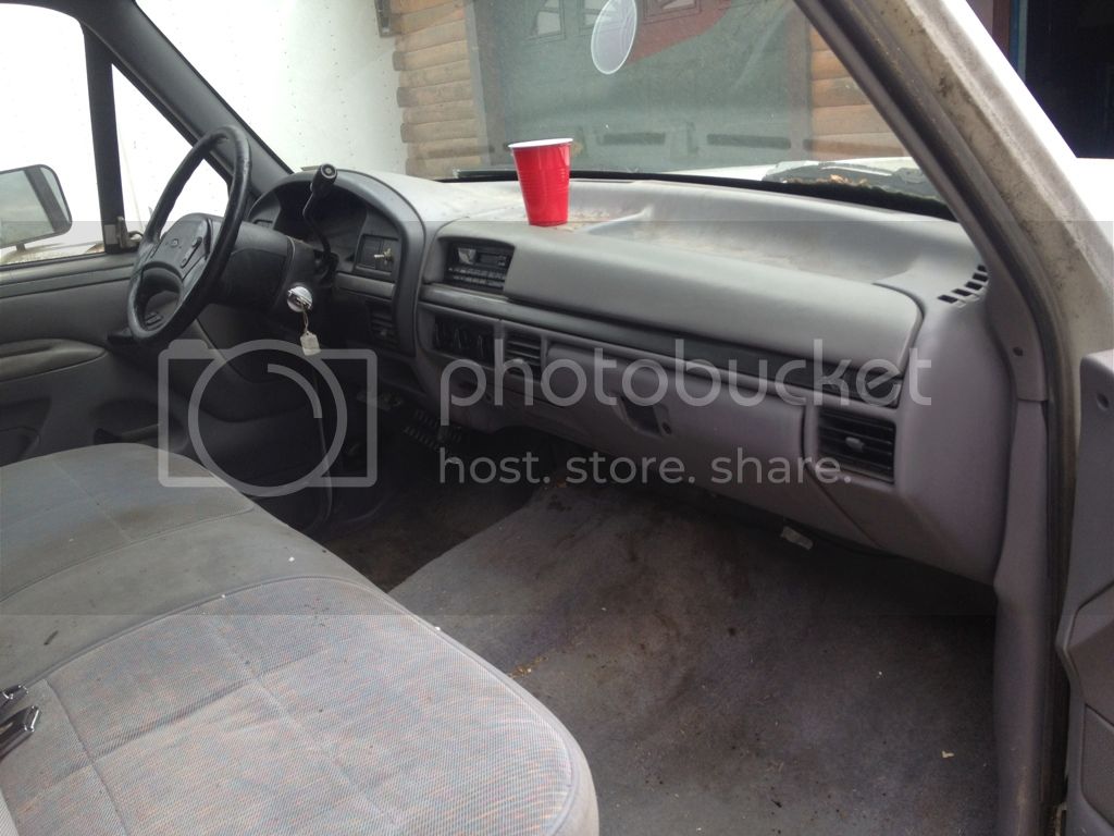

Step 1. Clean out the front seat, glove box, ashtray and pocket under the steering wheel. The door panels are a nice place to put stuff. Slide front seats back for room. Sweep off the floor if its real dirty, you’ll be laying on it a lot! Should look something like this when you start. Notice the red solo cup to put bolts and screws in as you take them out, if you a die hard ford fan you could use a blue one lol

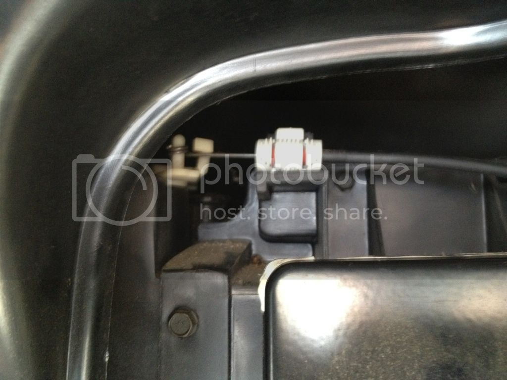

Step 7. (optional) I pulled the glove box out, just open it and give it a good tug upwards, drivers side slides out first, then you’ll see your abs module and a few other things. I did this to remove the heater cable, and loosen the antennae wire. But you could also get those once the dash is unbolted. Heres the heater selector wire (if you turn the heat selector to heat its easier to get)
The Antennae wire is towards the top right and goes through the firewall. Give it a pull if you can to get some slack, if not you can get it later

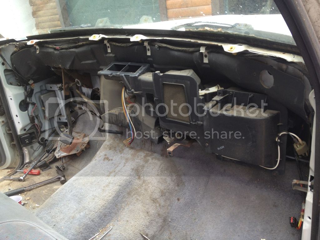

Step 11. Grab your cup of bolts off the dash and place somewhere safe! You don’t want it to fall. There’s four 15mm bolts that hold the aluminum piece on where the parking brake was. Once these are out the dash will drop. Remove the 8mm from the passenger side, and give the steering wheel a tug to pull the universal joint off of the shaft. If you didn’t do it before, pull the antennae wire out of the firewall and the heater control wire. And unplug any other plugs that you may have missed.
