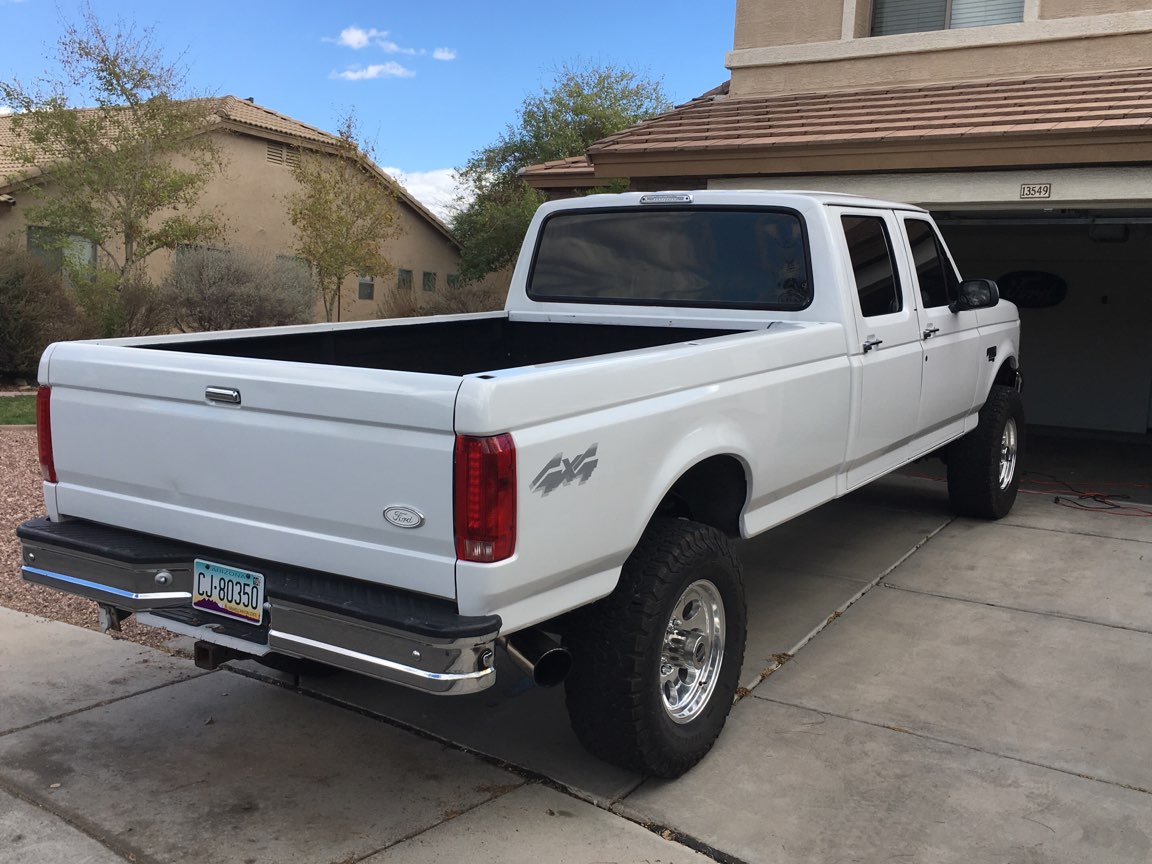

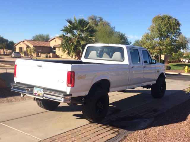

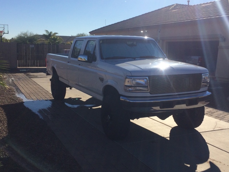

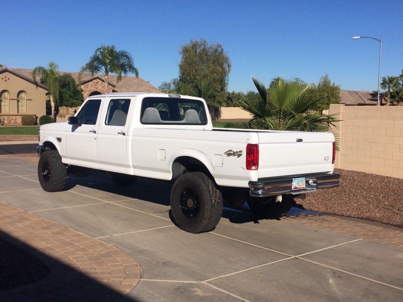

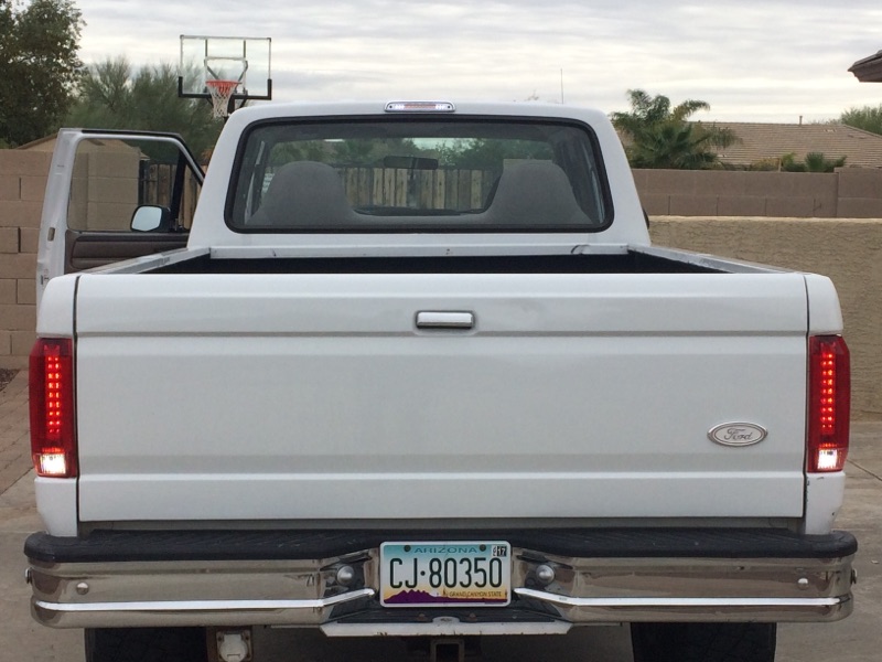

Thanks for the warm welcome and insight. Definitely appreciate the feedback. I have been tackling about one project a month since getting the truck. How do I post pictures? I feel that in in order since I'm new here.
961tonoilburner
Jan 10, 2017
10
I believe I've attached a few photos

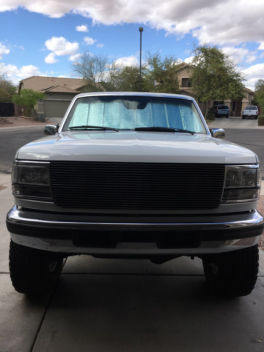

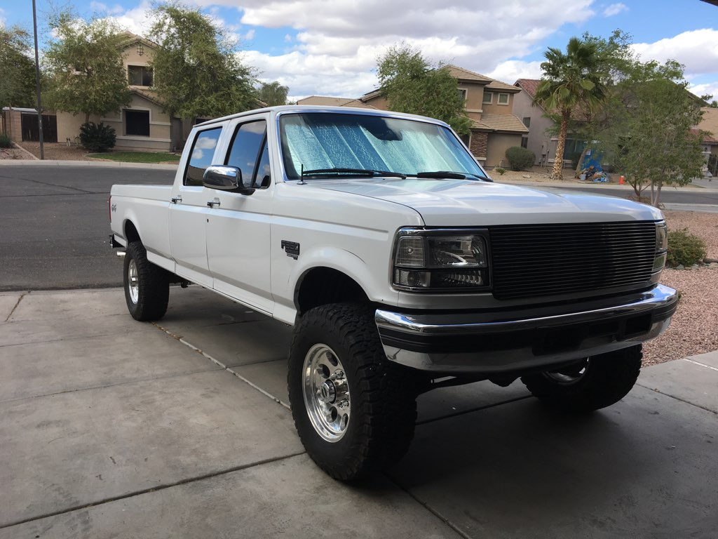

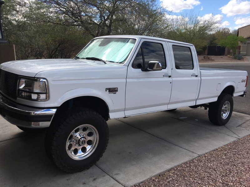

updated photos
had my b & c pillar grab holes welded shut and repainted. also had my passenger bedside repaired and repainted. new wheels (pro comp) & tires (35x12.5r18)

Thanks for the compliment. I am planning on doing a banks intercooler and e-fuel system next. I do not tow frequently but when i did, the EGT's (keeping it under 1200) limited me to about 55mph when pulling some grades between Phoenix and Victorville, CA. I was towing a 16' dual axle dovetail with a Plymouth Barracuda roller, complete drive train, several sets of doors, hoods etc. and mess of tools.
