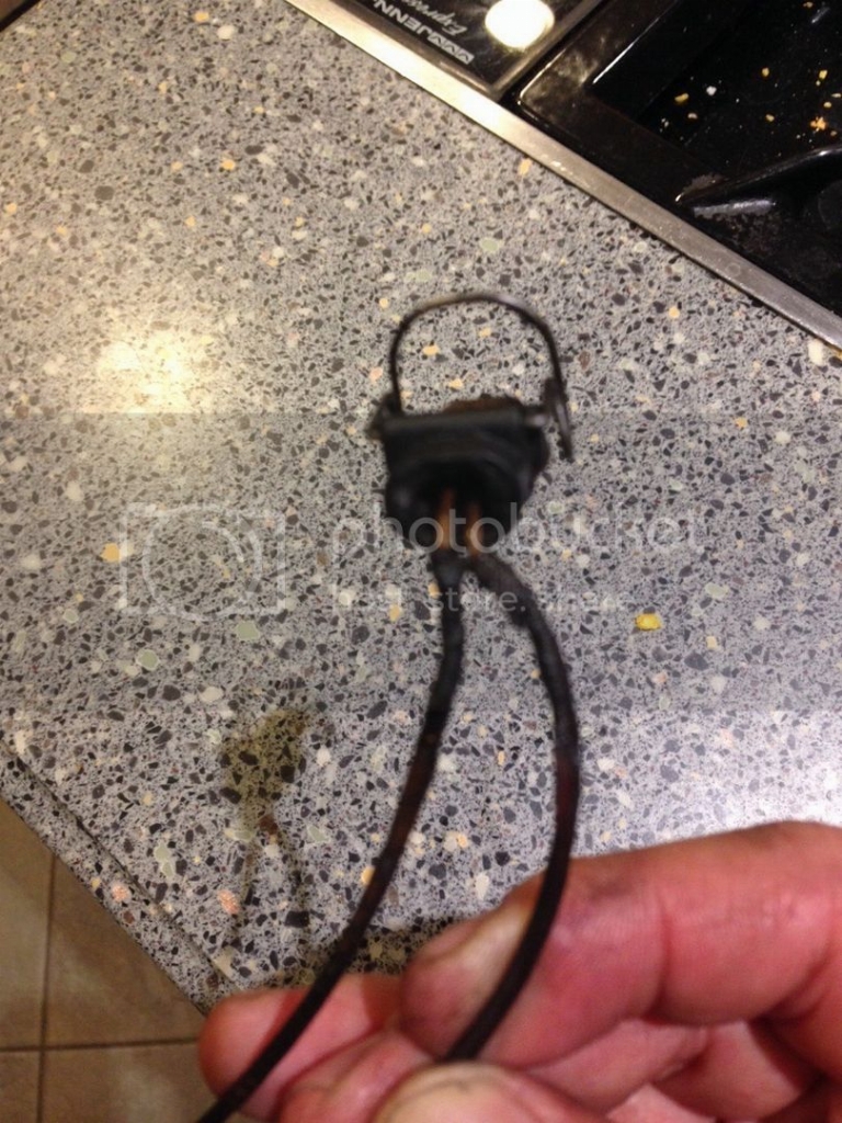

The voltage drop compared to the battery is concerning. The subharness that supplies power to the IPR also suppies to the IAH and the GPs as well. Are you getting good signal to those relays?
Have you closely inspected and checked the subharness?
I also added some info... its for an 02 but explains the wiring

Thank you ill take a look at it
