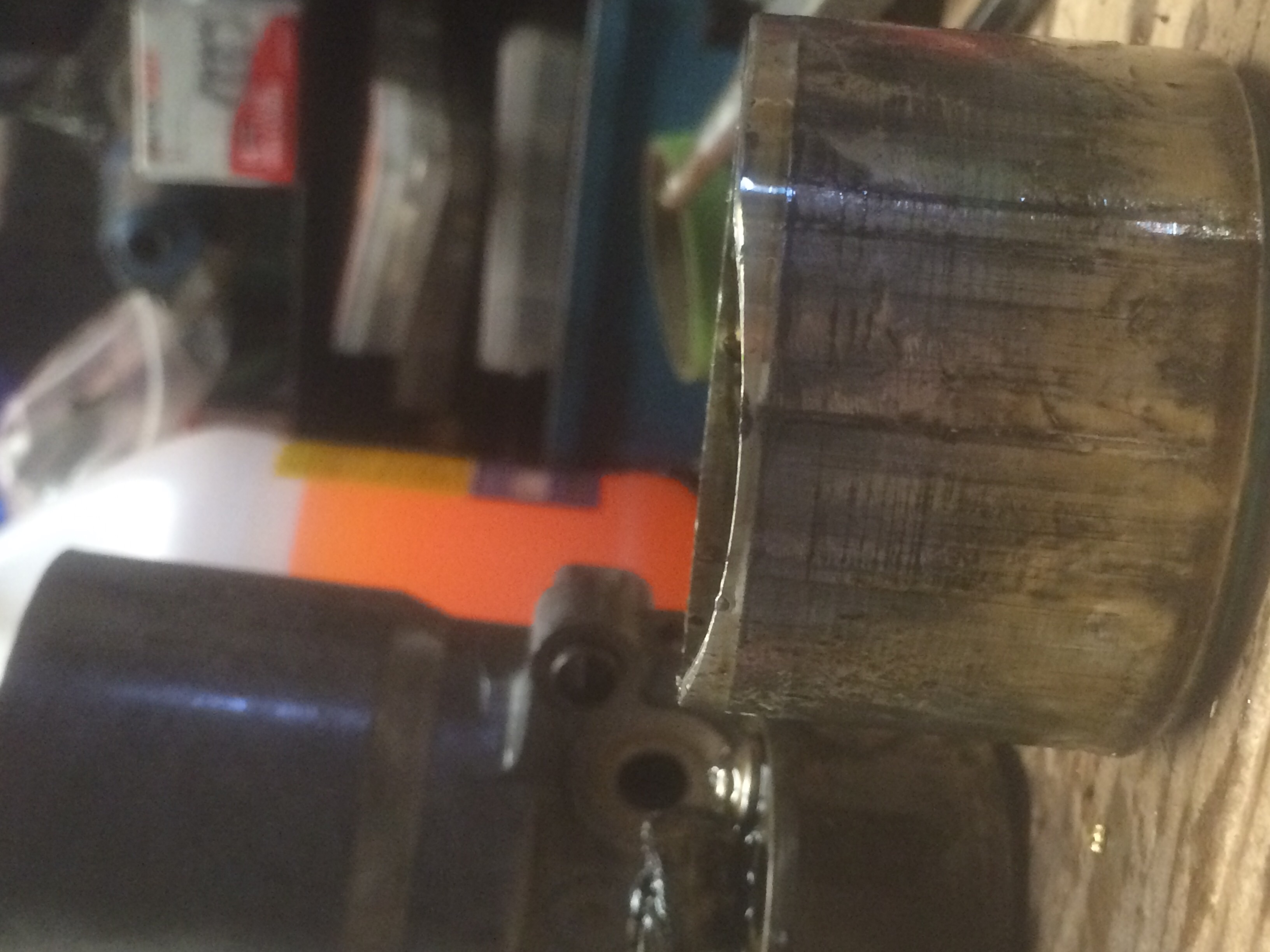

Long story short the hpop ate itself and put metal shavings through everything... My brand new injectors, oil cooler, rails ect. It punched holes through the ipr screen. And there were quite a few big chunks I found during the tear down. My question is does anyone know the procedure to getting all the metal out of the motor. I'm not putting brand new stuff back in with the metal lingering around waiting to wreck some more stuff. Everything was ford factory so the warrantied all of it and are paying me the labor to do it, just don't wanna be down this road again in a week when the rogue metal decideds its taking out everything again.

Nope there's metal through everything. The oil pan was full, the turbo, lpop. Ford had me tear apart the hpop to email pictures and it absolutely grenaded on the inside. I have pictures just unsure how to upload them on here.

How can I upload pics from my iPhone?

There paying for the labor because we're actually a diesel performance garage and we installed the parts. My labor rate is 75$ an hour but fords is 110$ an hour so they are actually paying me 110$ an hour. And that's what I said about getting them to just send me a running complete.. But they want me to pull the motor and disassemble the whole entire motor down to the bare block and take pictures and document the findings.. Because they are unsure the hpop was the failure. Which unless your blind you can see it was the hpop. So there sending a rep out tomorrow to look at the hpop because I really don't have all the time to waste and keep a bay tied up.

Unfortunately the only way to be sure that it's clean is to tear it all down and hot tank it and rebuild it. Best bet would be to get ford to give you a new engine. Good luck.

Definitely. Well the ford rep will be at the shop tomorrow morning to check out the hpop mess and see if we can fast track this and just get a new motor instead of wasting days of time for something we already know. I'll post some updates on what he says. Thanks everyone it's much appreciated
