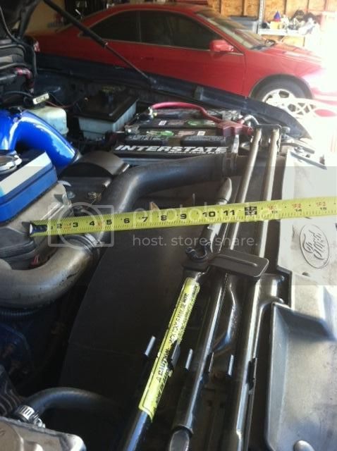

I am in need of a measurement from some of the CR conversion guys. How far back is your motor from the removable metal bar on the radiator core support? Can you measure from there to something like the front of the cast vale cover or the oil cap and post it.

OK Guys, Thanks. Mine is right at the 13 1/5 just like Deputy's picture.

mine is at 13" to the front face of the valve cover also. I made my own version of the GOS hub with just a little machining to the dodge hub, and using the 7.3 fan clutch and fan, plenty of clearance between the fan and the radiator

My 99 is 12.5 inches from the cross member in front of the rad (lift up the rubber flap) to the front edge of the rocker arm spacer under the valve cover. Same place Deputy Dog is measuring to.
I'm running a ZF6 with a custom (thin) adapter plate. The ZF6 is nearly in the stock position. I'm running a stock 5.9CR fan setup.
