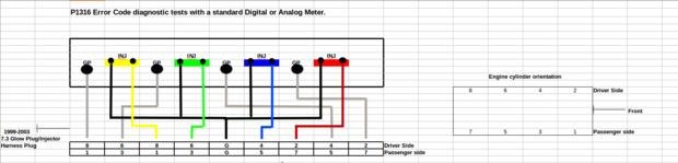

Here's some help. Been there done that.
Testing notes for my Early 99 7.3 injector / glow plug harness under the valve covers
1. During the continuity check of the glow plugs, attach the black meter lead to engine ground somewhere on the head. Touch the positive meter lead to the head and obtain a baseline resistance reading.
Make note of it.
2. For each glow plug checked, the resistance should be .9 to 1 ohms, but no greater than 1.5 ohms. If it is, your glow plug or gasket connector needs replacement.
3. If you read OL (digital) or no meter swing at all (analog meter), you have an open wire or bad
contact on the harness.
4. For the sake of consistency, check each glow plug connector for continuity first.
Then move to the injector continuity test.
Injector Coils
Place the meter red lead on the harness yellow, green, blue or red wire. Place the black lead on the black wire (center lug). The meter should read around 1.0 ohm.
Take all the injector measurements and compare. They should be balanced. If you see one out of whack, you have a bad injector coil, connector or loose wire.
Again, when checking injectors for continuity, always set the meter to the lowest ohms setting.
Simply look at the illustration and make your measurements based off the Ford harness.
Note*
Large lugs in the connector are for glow plugs (High current).
The smaller lugs are for the injector wires.
The center lug is always ground.
Factory Harness color codes
White = Glow Plugs (Large lug)
Black = Injector Ground (Center)
Yellow = Injector 1/8 (Smaller lug)
Green = Injector 3/6 (Smaller lug)
Blue = Injector 5/4 (Smaller lug)
Red = Injector 7/2 (Smaller lug)
CAUTION: Some 7.3 PCM’s (California program map) do not like after-market glow plugs resistance values. They will cause P1316 error codes. You must use factory spec glow plugs to clear the code.
Burned wires/connectors cause problems for IDM's. If you look at the connectors, you'll see what I mean. Burned components cause an increase in resistance.
Pull your valve covers and inspect the harness and connections. DO NOT USE COMMIE DORMAN VALVE COVER HARNESSES, THEY SUCK.
Ask me how I know that.
Spend the money and get OEM.
Always use the 120 IDM on any 7.3 (Look at the tag on the box) 100 & 110 IDM's are just too wimpy to get the job done.
120's run the best.

1st and foremost, Merry Christmas to you too!!
On your turbo and up-pipes, yeah, best to wait until you have those up-pipes in hand.
I was lucky enough to have read about those up-pipes while I had my trans pulled. They were easy to replace with the trans out. Because of that, I didn't have to yank the turbo, just the 'Y' pipe. The 'Y' pipe needed the flange surfaces cleaned up a bit from a wire wheel, and I chased the threads with a metric tap (M8 x 1.25? I think), but that's all I did to it. The clamp was in good shape so I reused it. I was fully prepared to yank the turbo and pedestal (Pedestal 'O' ring kit), but simply didn't need to.
On your injector coils: it really sounds like you've got some issues there. Mine were all balanced in their measurement, none being out of whack at all. I know that doesn't make you feel good (It wouldn't me), but facts are facts. If you have to change the injectors, it's a job, but worth every penny spent. Besides, at 300K miles, you're due anyway. It's common knowledge these engines can go a good 500K before they need a full rebuild- if you take care of them (air, oil fuel filter changes, etc). But yeah, you'll be putting some money in them along the way.
Regardless of which way you look at it, it's still cheaper than a new truck. Even if you were to throw a reman long block in there, that's only 5K for a new one. If you bought a new truck like my neighbor just did, he's now got payments for a $38K truck (Dodge gasser, nice truck sucky payments).
His payment will tip the scales at around $600 or more a month. Gee whiz, at that rate, if you buy a reman long block to install, you'd be done paying it off in about 10 months, all things equal.
Anyway, those gasket/wiring looms can be a pain in the arse to troubleshoot, which is why I logged my findings. Oh, and if you removed the little air breathers on the valve covers, grab the O-rings that fit under them. You'll need to replace them because you'll never get them back into the hole they came out of, they swell up from oil penetration.
If you were able to remove the valve covers without taking them off, you're golden. When I had my covers off, I took the opportunity to swap out my glow plug relay, install new OEM glow plugs (they're cheap, do it now!), change my fuel filter, clean my air filter (I run a K&N) and do an overall inspection.
Keep us posted on your findings. I am very curious about the resistance measurements you are getting on your injector coils.
Oh, and if I were you, I'd change the battery in my volt meter. If you're getting inconsistent continuity readings, the battery may be weak. That is the first thing I do when the measurements are all over the board. Those coils (and glow plugs) should be consistent across the board. Like I said before, if they're not, you have resistance from burned contacts on the hardness, open wires, or a bad coil or glow plug.
Glow plugs should be a dang near short (1 ohm) to work correctly. They work on current draw to heat up, NOT voltage. That's why your harness will show evidence of heat on the connectors.
injector coils on the other hand are opposite. Essentially they work on voltage, not current. That's why when you boost your IDM output voltage with the resistor modification, they will work a bit better because depending on the IDM part number, you are upping the game from 100, 110, 120 volts to 140 volts. Folks have reported a crisper throttle, idle as smoother. In a stock engine situation, most felt a power increase. Not so much in a highly modified engine. You can't get much more than the limit of the hardware, law of diminishing returns applies here.
As far as I know, I have seen no reports of damage to injectors or of the IDM whatsoever by doing so and the mod has been employed for several years now. You can see how to do it by searching the net. Nothing new there.
