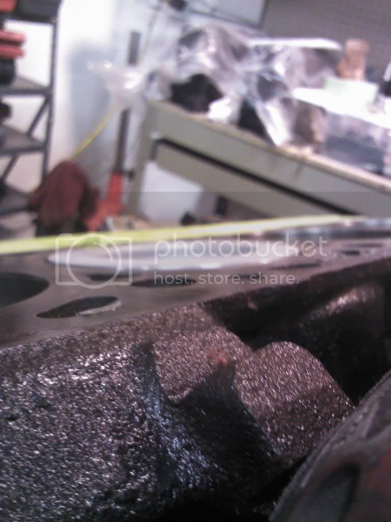

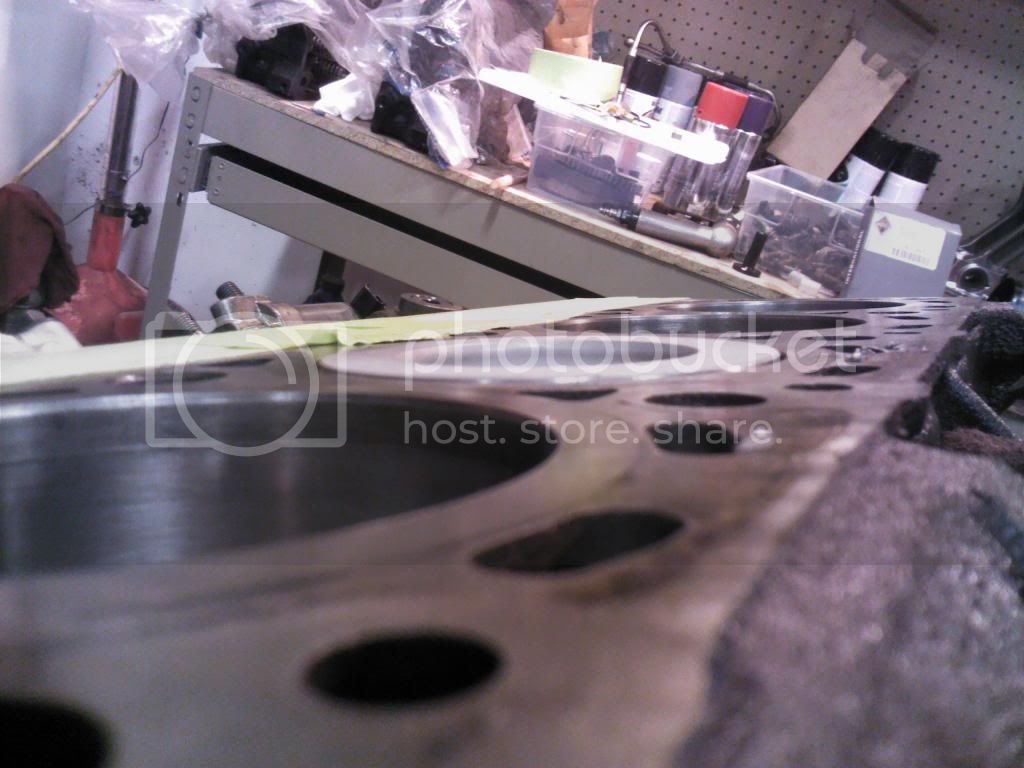

[QUOTE="Morgan@Midwest Diesel & Auto, post: 590567, member: 8143"] All 6.4 pistons protrude like this one. The ceramic coating only adds about .002" to that. The 6.4 runs close anyway. If you deck the block then you should cut pistons down accordingly. Otherwise in this case your good to go. [/QUOTE]
