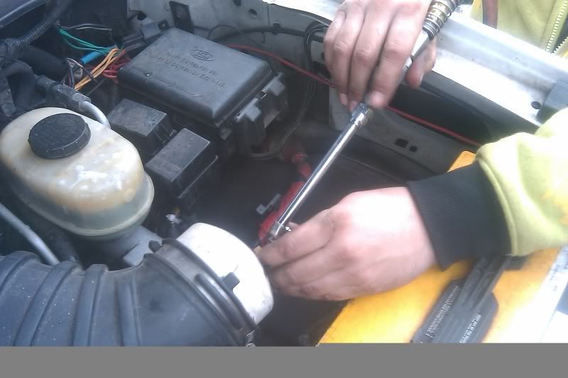

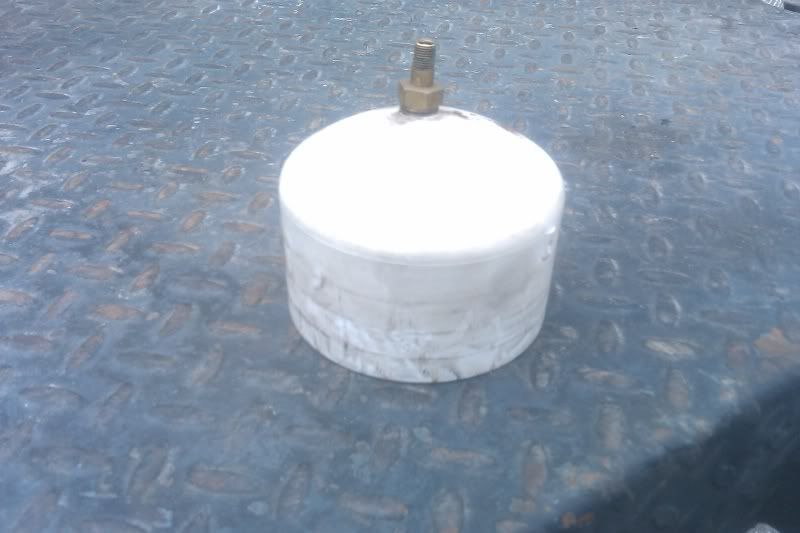

Are you sure that you dont have oil leaking from around the boots? I had that happen on mine before I did the ccv mod and it would run down the head like you described. A boost leak detector will tell you for sure if the plenum boots are leaking.
positive, wiped all them down with a clean white towel, dry as can be. Id be very surprised if snugging down the bolt that wasnt tight stops the seeping, but ive seen crazier sh!t happen.

Boost leak detector and some soapy water will tell ya if its still leaking there.
