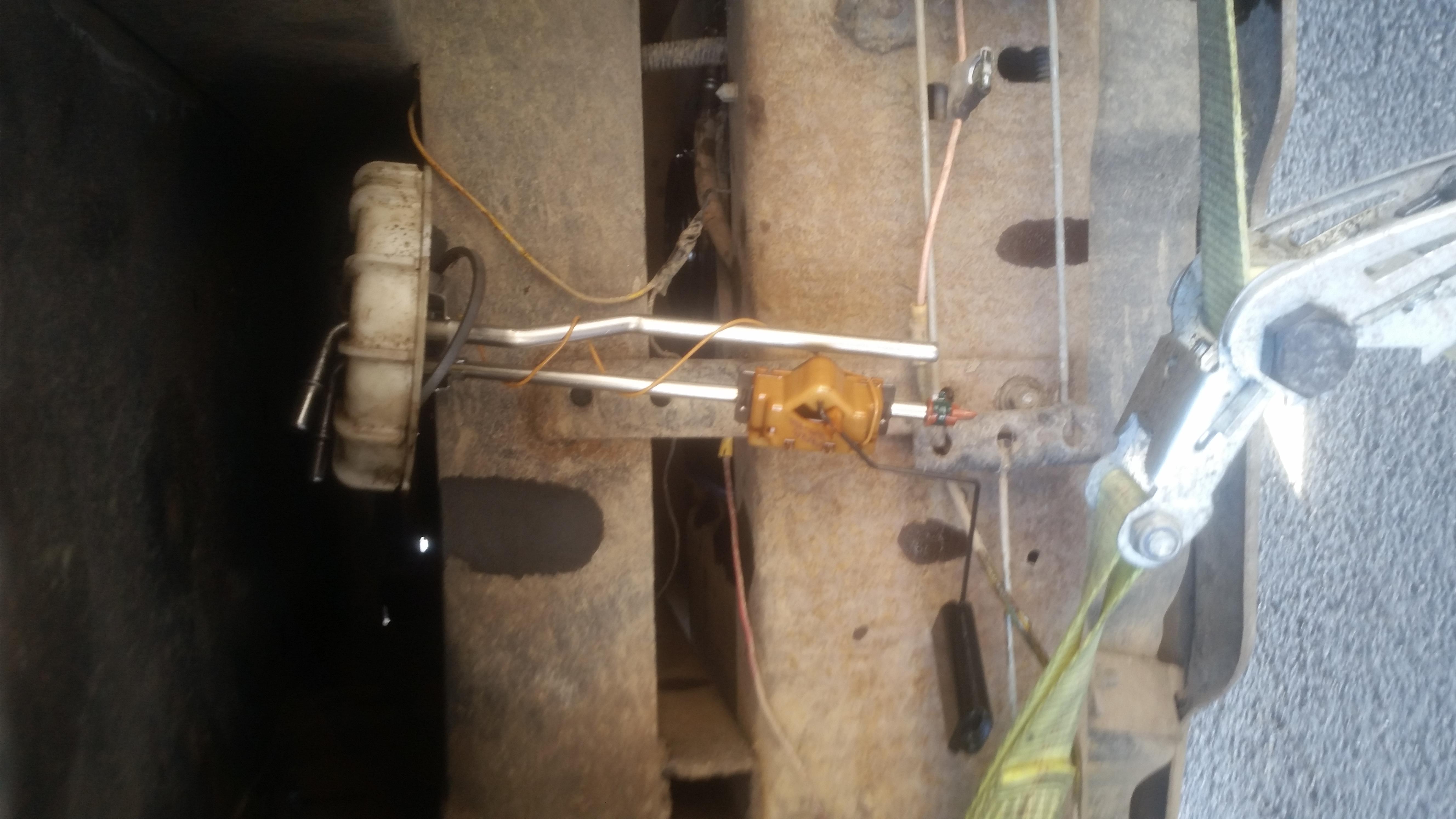

I pulled the fuel pump out of the front tank didn't even see a screen on it. I took a pic of it. Doesn't look like any fuel pumps for this year truck with powerstroke. Makes no sense to me don't know if it had fallen into the tank or what.

Ok so new filter on top of engine. Anytime I have had a failed pump it goes out and it doesn't come back on so. Do I need to pull something off ie pump in valley and clean something or should I start replacing stuff fuel wise. O rings on injectors?
