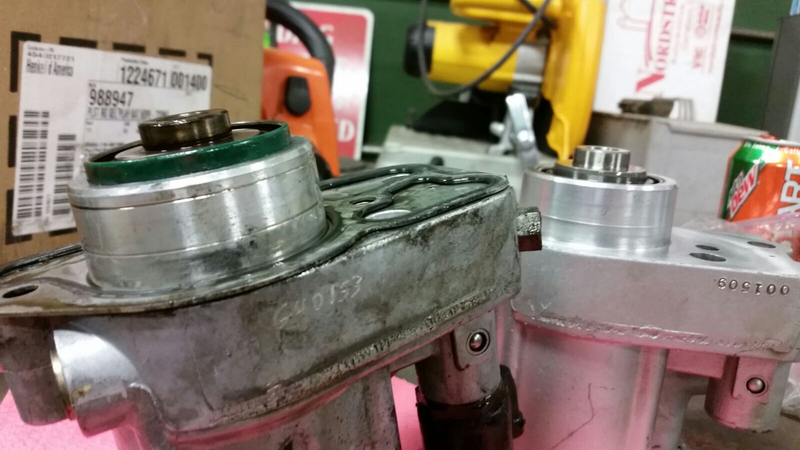

So that brings me here.... When I pulled the t500 it looked like this. Is this not a seal pushing out?
Arisley
Moderator
9,385
31
Arlington, Texas
Pull the SRP out. Compare them. If it is, get something that you can span the seal and tap it back in. If there is a missing snap ring, pull it off the SRP and put it on the T500. Don't even think about where the missing snap ring went, it will drive you absolutely nuts.
