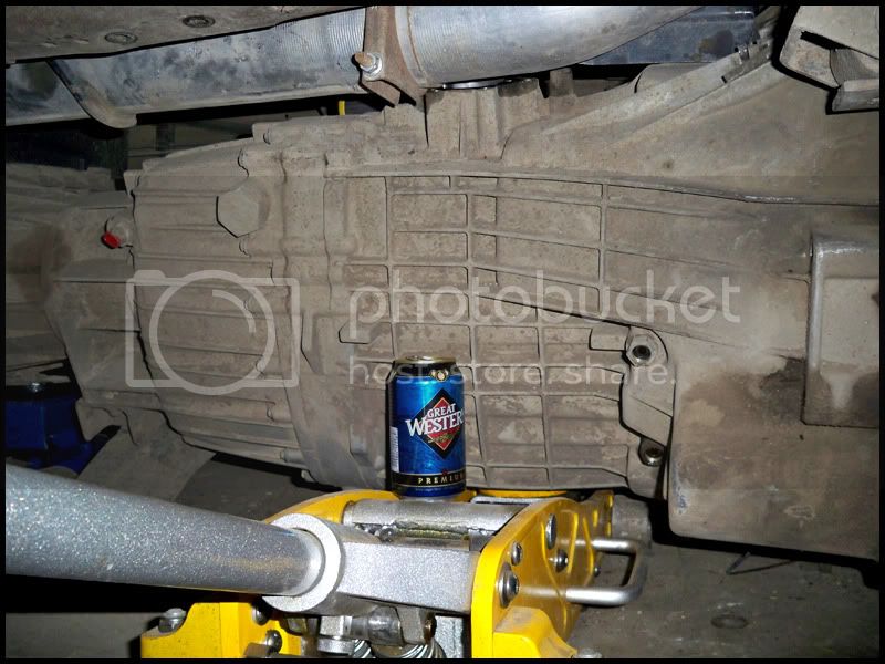

Just finished a clutch job on a ZF6

That is one big beefy tranny. It is definitely bigger than the ZF5. I really like the idea that it has cooler lines, I could see adding a larger cooler and inline filter. My buddy was trying to tell me the Dodge 6 speed is beefier, I'd have to see it to believe it. And I doubt the Dodge transfer case is as stout. Someday I will have an older crew cab with a mechanical 12v, ZF6, and 3:55 gears so I can enjoy good fuel mileage, reliability, and all in a well built truck.

What model dodge trans?
If he is talking about a G56 in the common rails, he is full of ****.
If its a NV5600 then maybe, but its a cast iron unit, apples to oranges
ZF6 uses a center support bearing that makes them much stronger and less prone to flexing under high load like the g56 thats an aluminum case trans

I have worked on a number and have sold 100s of zf-6s and a few nv5600. Hes full of ****. The nv5600 is also a hateful bastard to disassemble. It doesnt split like the zf 6 does. They fail more often and are way more expensive to work on.

A bit surprised/impressed when I did my clutch too. ZF-6 versus the bar-bell T-5's I'm used to working on and carrying around by hand is hilarious.
Just about crushed my skinny ass, but I got er' done, lol.

Yea he was talking about the 5600. Good info on the center support.

The ZF6 is the strongest manual trans installed in a one ton or less truck hand down - if the bell-housing wasn't integrated I would bet you would find people swapping them into anything and everything that requires some significant strength. And I have done my fair share of busting the hell out of the ZF6-S650.... The only weak spot is the input shaft splines can wear a bit easily and the trans really needs the larger output that CAN be found in some of the new revisions of the transmission that are found behind some of the 6.0 trucks IF someone were to want to go sled pulling in say Hi range 2nd and launch at say 4500 RPMs...... using 3.73 gears and 33" tires... LOL

dang, it looks big while your under the truck, but actually seeing it brought down now i can clearly see it's HUGE!

That looks like a tiny can of beer. And little midget floor jacks.
Holy crap, not gonna bench press that puppy up there, and hold it in place with your knees while getting a couple of bolts started.

You guys would enjoy life better if you removed the driveshafts, T-case and trans separately...
I can't believe I saw the trans, t-case and driveshaft(s) all still attached laying on the floor. Was the goal to make it as cumbersome and unwieldy as physically possible?
