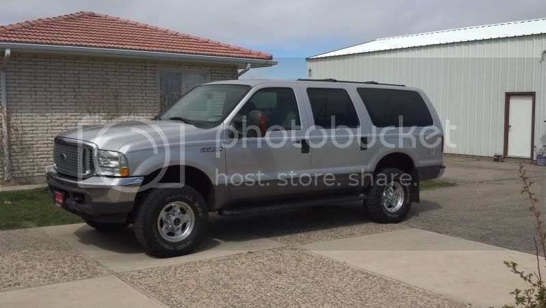

This is the wifes new grocery getter. Got rid of her 10' STi for this. I always felt kinda dirty having a Japaneese car. Back to an all Ford stable.
It's a clean 04' with 69k. XLT. About the only thing it doesn't have that we wanted was leather. That can be fixed though.
It's on 285/75/16s right now. It looks to be a little taller than other Exs we've seen. Could this possibly already have V and B springs? What would I look for?

OK someone has modified your leafs. It sounds like they went down the add-a-leaf path.
You say there are 3 leafs upfront. All the Stock only have 2 that includes the V and X codes if they were upgraded. So someone added a extra leaf.
On the rear has 7 total leafs IF you are counting that last overload swing that has the bump stops on the end. SO I am not sure what is going on there.
35 on any mass produced wheel will rub on the front. The X needs 4.5" of lift to properly clear 35s
The rear springs on the X are actually much stiffer than a F250-350 in first stage travel. Because they had to be dearched for the X to fit in most garages the spring pack had to be stiffened to still keep its 250 rating so its lower with higher pounds per inch of travel. What the X needs for on the road use and towing is a rear leaf that has more travel and stiffness right in between its current and a standard 250-350 rear pack. That is why you see the B code F code modded packs how tos.

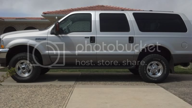

I tend to agree with you on the add-a-leafs after looking a little closer. On the rear at first glance it looked like all the leafs had the factory type ?teflon? pads. After closer inspection you can see the fifth leaf has a different kind of friction pad. As you can see in the pic, these springs have had the leaf with the bump stops removed, and there is no spacer leaf. They are all load bearing leafs.
There is no doubt that the back is softer than the front on this Ex. There is 4" between the bumpstop and the ear on the block in back. There is about 1.5"-2" (it was on uneven ground when I took a quick measure) between the bumpstop and pad up front.
