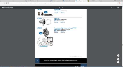

Agreed. Last year when I talked to them they supposedly were building all new from the ground up k16s that were to be stock bore, 30% stroke, 60% and an 85% version. Now just 2 weeks ago I call and they will be offering their own Reman model in stock volume only. So Idk what they will end up doing.

TD-5
Sep 12, 2013
284
British Columbia Canada
