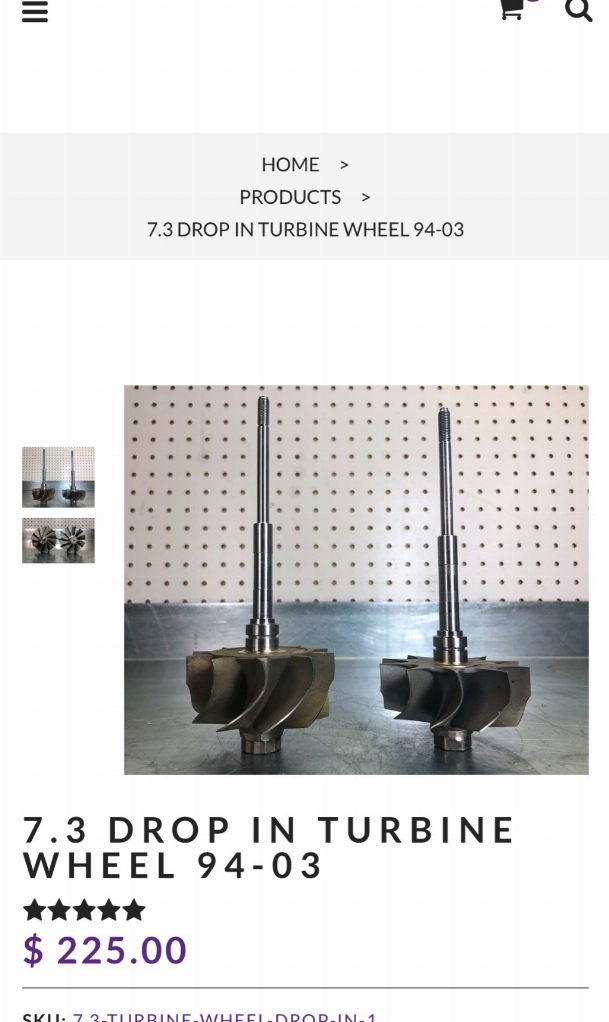

I found the shaft I was talking about
I have a 1.0 ar- would it fit fine?

Those are the turbine wheels we are currently testing. (we sent out 40 testers last spring and everyone loved them).
The SUPERDUTY 99-03 units are OUT OF STOCK
We have the OBS 94-97 units in stock ready to go.
They will fit any a/r housing as long as you order the right size turbine wheel
