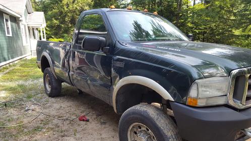

So just an update. Here is the before an after of the truck, still some work needing to be done but almost there. Bought it dumped in a ditch with a blown motor. Turns out I didnt not have a front leveling kit so I just got one in a will be putting it on today. It did hit the front fender with out it pretty bad but other than that it works great. No float feeling with the tires very solid.
