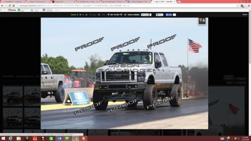

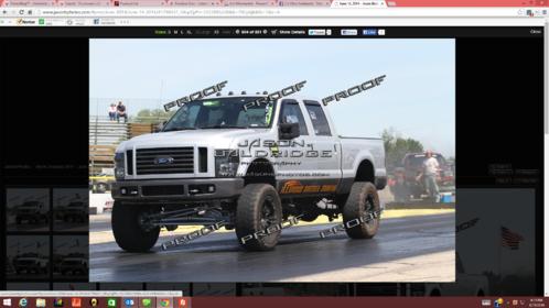

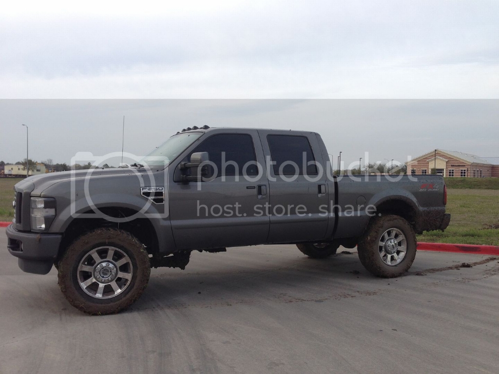

6" bds lift
20x12 -44 offset
37x13.5 Toyo

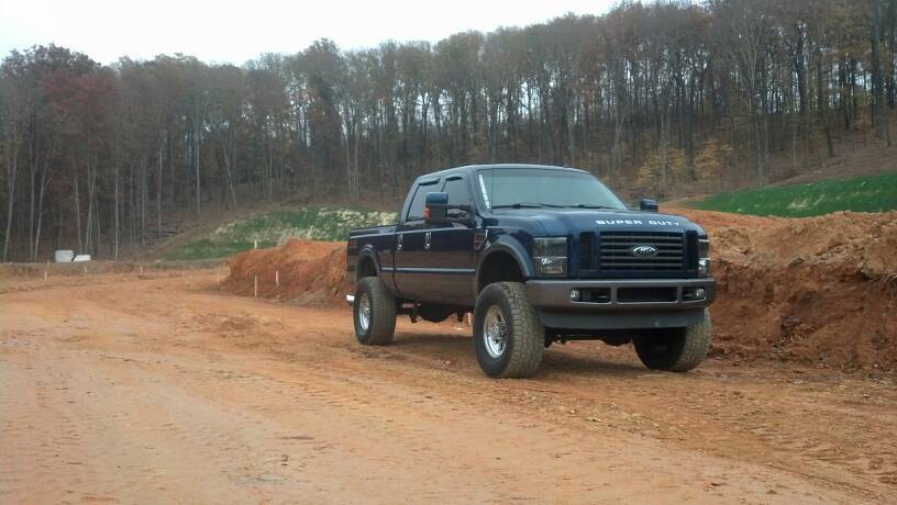

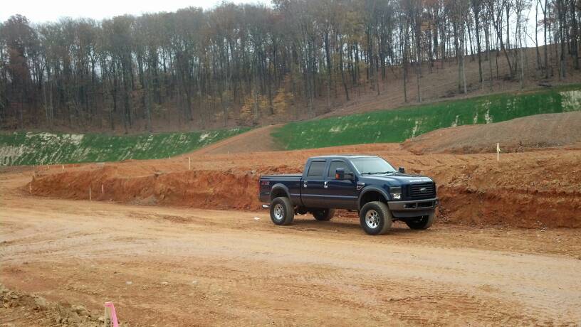

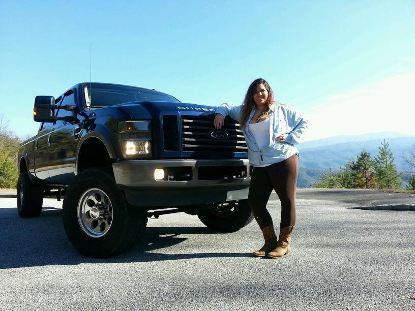

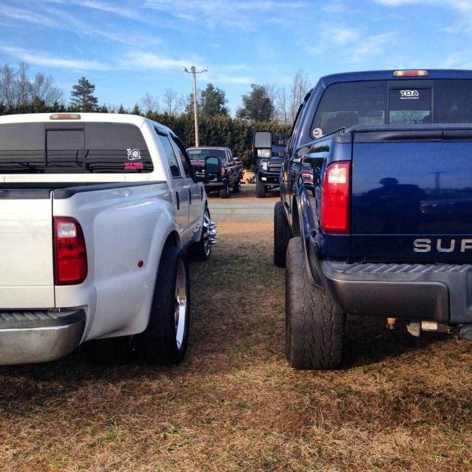

heres my old setup (under the knife currently) 8" procomp dual coilover lift, 37x13.50 toyo's on 20x10 RBP 94R's, got me some of them 22x14 fuel octanes, coming in this week, then powdercoaters will get ahold of them. so should have new pics next week.

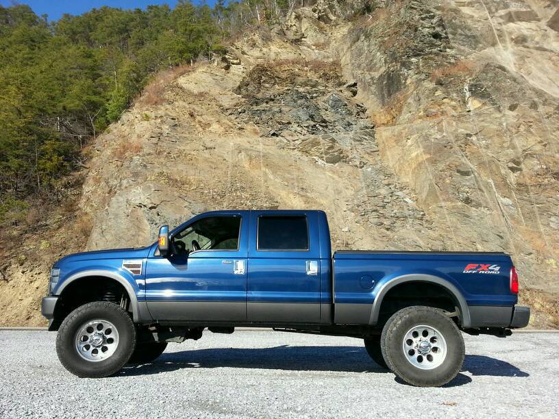

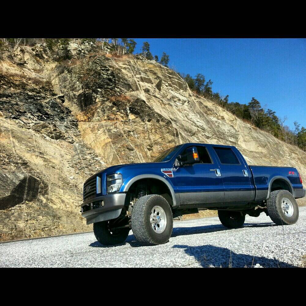

3" RCX lift and 37x13.5x20 Kuhmo MTs
truck looks awesome....did you have to do any trimming at all? I'm really digging the 3" lift, did you have to do radius arm drop brackets or any drop brackets at all? I'm gonna try to put 37's on with 2.5" of lift I think it should it will work pretty well.

I did a very small amount of trimming on the inner fender blanket. I do rub a little on the radius arm now, 12.5s would really fit better, but I already had these so I just went with them.
The kit included radius drop brackets, trac bar drop and new shocks. The thing is this kit has a super stiff ride that I can't stand anymore, so I'm going to be pulling it off soon and haven't settled on the next setup.
