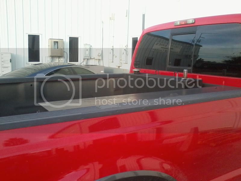

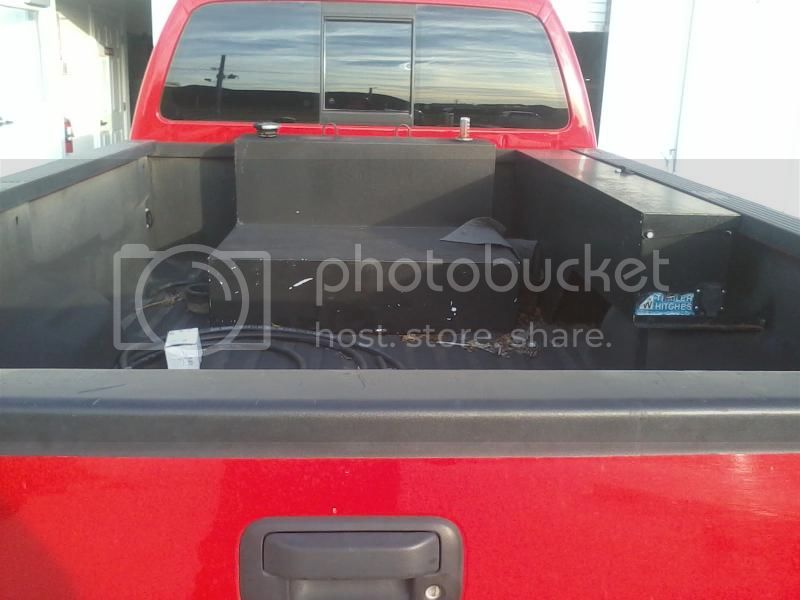

This is what I have but it's nothing special. These pics are kind of old but the only thing that's missing is my transfer pump for the equipment. It's gravity fed into the vent line of the main fuel tank,

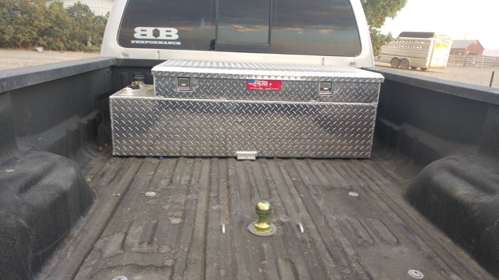

I am planning to run the RDS 60gal gravity feed tank. I will likely install an electric ball valve on it wired to one of the upfitters. I want to run a tonneau cover with it, so the toolbox combo will be too tall.

RDS 60 gal tank/tool box combo
Gravity flow.

I really like the rds, 60gal of storage + toolbox to fit my Milwaukee 1/2 impact and hard case, socket set, 12 ton jack, ratchet straps. All while staying flush with bed rails. I also occasionally use a trifold tonnea cover that fits perfect as well
