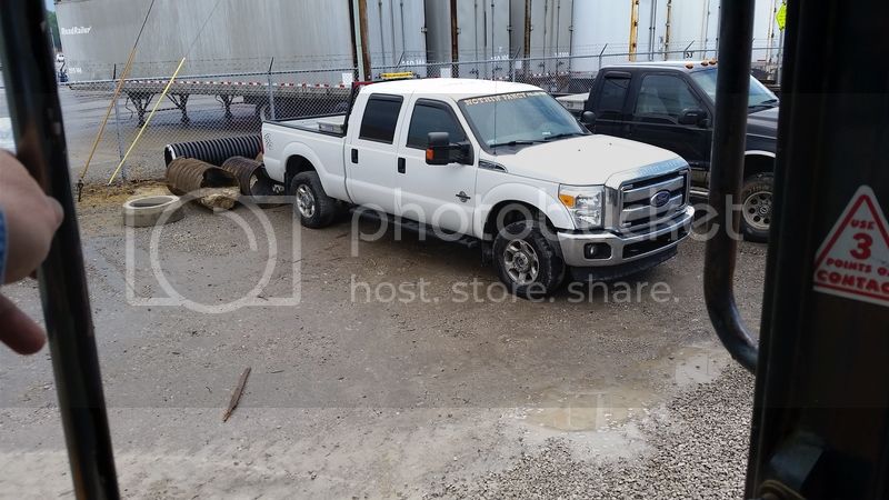

Not exactly hidden, but I have flush mount LED cubes in my rear bumper I use for loading/unloading at night, extra reverse lights, etc. I've been looking at adding a strobe controller to them, in case I get caught on the side of the road/stop to help someone change a tire, etc.

That's honestly my main reason, I pull over quite often to help. At night, the strobes would make it WAY safer.

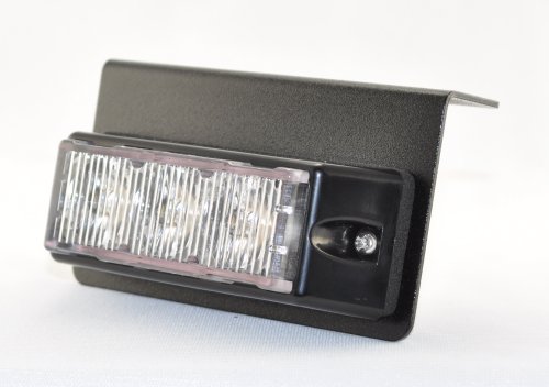

I've got two 3 led flashers setup in my grille and 2 on my license plate in blue for the fire dept. Super bright and didn't cost a ton. I've sold several amber ones to farmers for use on farm machinery as they are way better than what is stock. You can see they are the small ones at the top of the pic.
