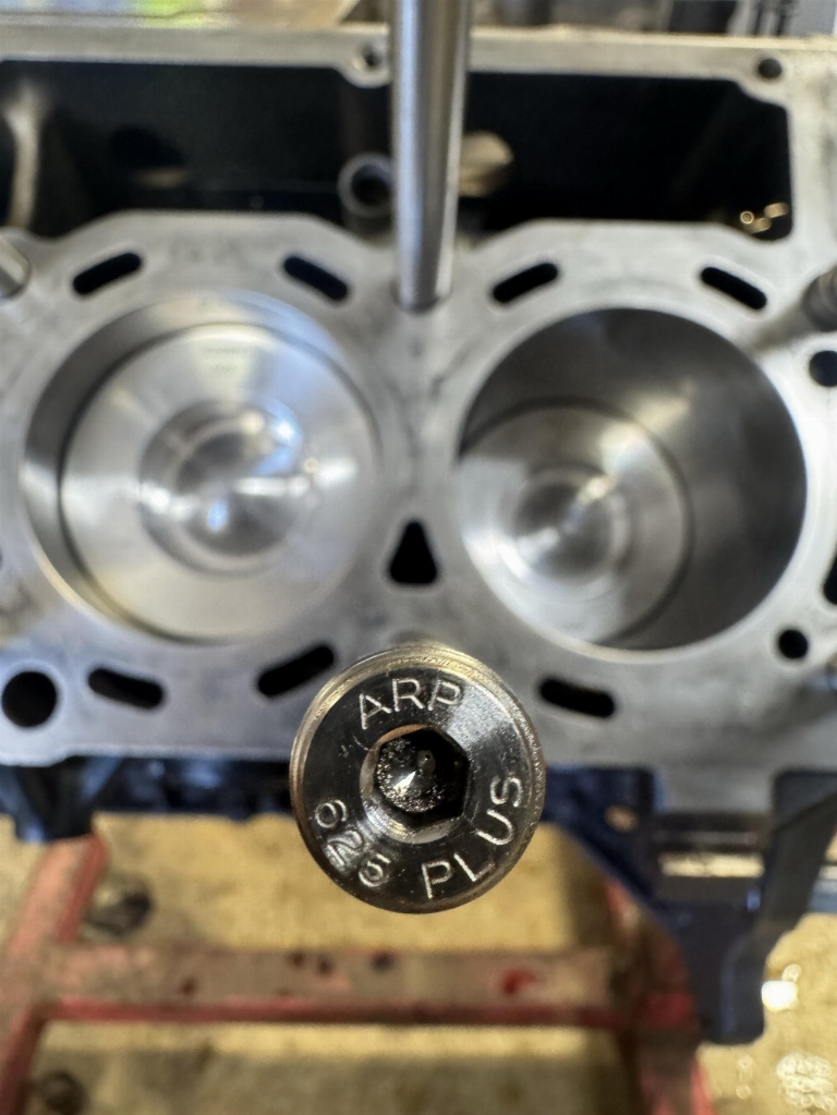

I made a post on here years ago about a 750hp 6.0 build. Life got in the way yadda yadda, no excuses. Here we are. Trying to get this done before I get a family started, priorities right? The truck is a 2006 F250 FX4 that I bought back in high school. Deleted it right away and a few years later, ditched the stock vgt and installed an S364.5SXE. Been running it for years on stock head bolts with no issues (another reason this has been delayed). Fast forward to now. I have a spare engine I am going to build to swap into it. The goal isn't set in stone yet, but I do not want to have to tear back into it too far to add power later. So far the build list is as follows -
Block has had all machine work done and is bored .020" over
ICON aluminum heads (not the race ports as this truck will be streeted still)
KDD Stg 2 Cam, OEM lifters and Chromoly pushrods
225/100 RCD injectors
Thumper 2 hpop
Callies Ultra Assassin Rods
Turbo will stay the S364.5/68/.91 for now until the engine is "broke in" and all the kinks worked out
FASS 220
Strictly Diesel reg return
Odawg S2R intake
Banks intercooler, piping and intake horn
Stock Mahle pistons
Transmission is full billet Warren, should be capable of 1000+hp
RCD LPOP
No limit intake
At this point, I'm contemplating 625 studs. I have a set of 425s that have been torqued once but were never ran. At what point are billet rocker bridges a must?

I would do 625s, have still seen issues with the 425s at higher boost levels, seems 625s and o rings, and it’ll hold 50-60psi for quite a long time. The billet rocker setup is more for rpm than power. If you’re gonna regularly see over 5k ,ala race truck, then get them. If you’re gonna keep it tuned to a reasonable rpm range, as most tuners will do, then you’ll be fine with stock.

Heads are currently on a 4-6 week lead time. Nearing the end of week two, can’t wait to see these things. 625s have been added to the list. I’m too deep to start trying to cut corners now lol.

Well the heads finally showed up this week. ~8 months from the day I ordered them so I hope they are worth the wait lol. Made a lot of progress today. Started this morning with a bare block and by 11 pm the engine is 90% complete, just need to get the old engine out and get the flex plate, rear cover and a few other things swapped over. Will be installing the FASS and sump while the engine is out and hopefully have this beaut stabbed back in tomorrow.

She’s alive and runs great! I’ve put about 70-80 miles on her so far and haven’t had any issues. Running a light “tow” tune on it to break it in a bit before I start pouring the beans to her. Haven’t been past about 80% throttle just yet but even at that I’m seeing about 42psi boost. Turbo lag is virtually nonexistent at about 1700 rpm and above, and it will actually start making boost at around 13-1400 rpm in overdrive tc locked. Couldn’t be more happy with it! Just can’t wait to see how it runs with the full fuel race tune
