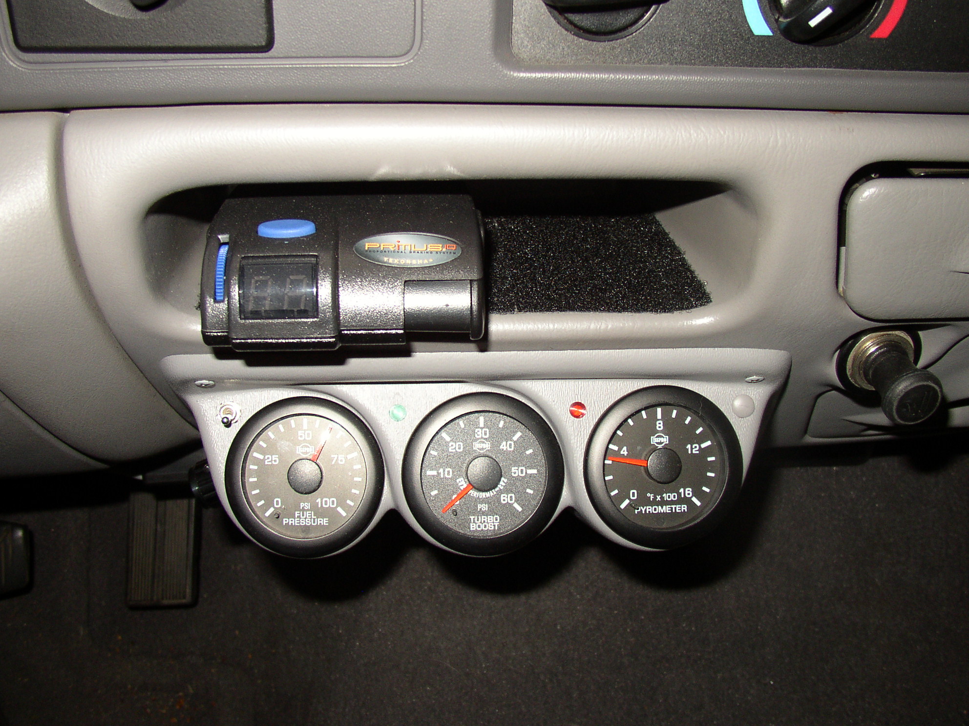

aeroforce scan gauge covers all of the OBD data and mine is on the steering column mount. My other gauges like boost, fuel, egt are in a pod below the dash.

Little off topic, but id love to move my brake controller in that hole, how hard was that?
mandkole
Jan 14, 2012
2,305
Northwest
Pretty easy and works good-- male/female Velcro, a hole in the back for the connector. IIRC, the Primus had its own self leveling feature but I tried to keep it as flat as possible anyway. Still have a good portion of pocket (great for a wallet) and the Velcro keeps everything from sliding.
