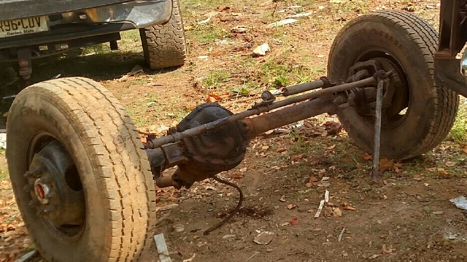

Also the dana 60 i got is from an 80s f450 do i know the brakes are different. My question is are mine current brakes better and if so is there a way to swap them onto the dana 60

Here is a pic

Should the one in the pick be an issue putting in my truck, and I'm not familiar with the different brakes. Are those the same as my 97

Yes and no.
They should be different in that they use the older slide pin setup to hold the caliper on vs your style with the bolt.
I've seen conflicting info on if it can be swapped.

Brake Pads are not interchangeable and are smaller if I remember right. I never feel like it braked as well as the 97 brakes.

Damn that sucks, I'm gonna do some digging around see of anyone swapped the newer style brakes on an older axel since I'm gonna tear it apart to replace everything anyway

I think I missed to 2wd to 4wd part.
I thought you just had a older d60 to replace a current d60.
The brake swap I'm thinking of you swap the d60 knuckle.
Can't really do that here. Lol
