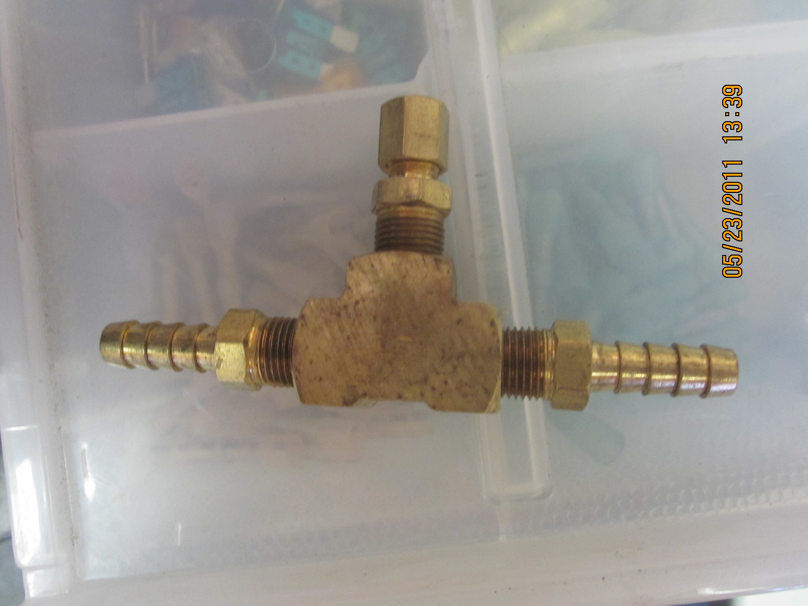

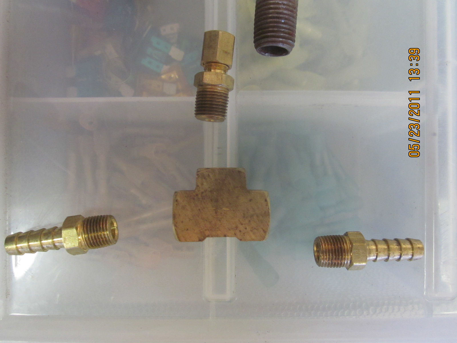

Home Depot...

WHS^^^ home depot has the same stuff cheaper than most places. And it may make a difference in the boost it reads, but its a vacuum so it should be trying to suck it together than blow apart
