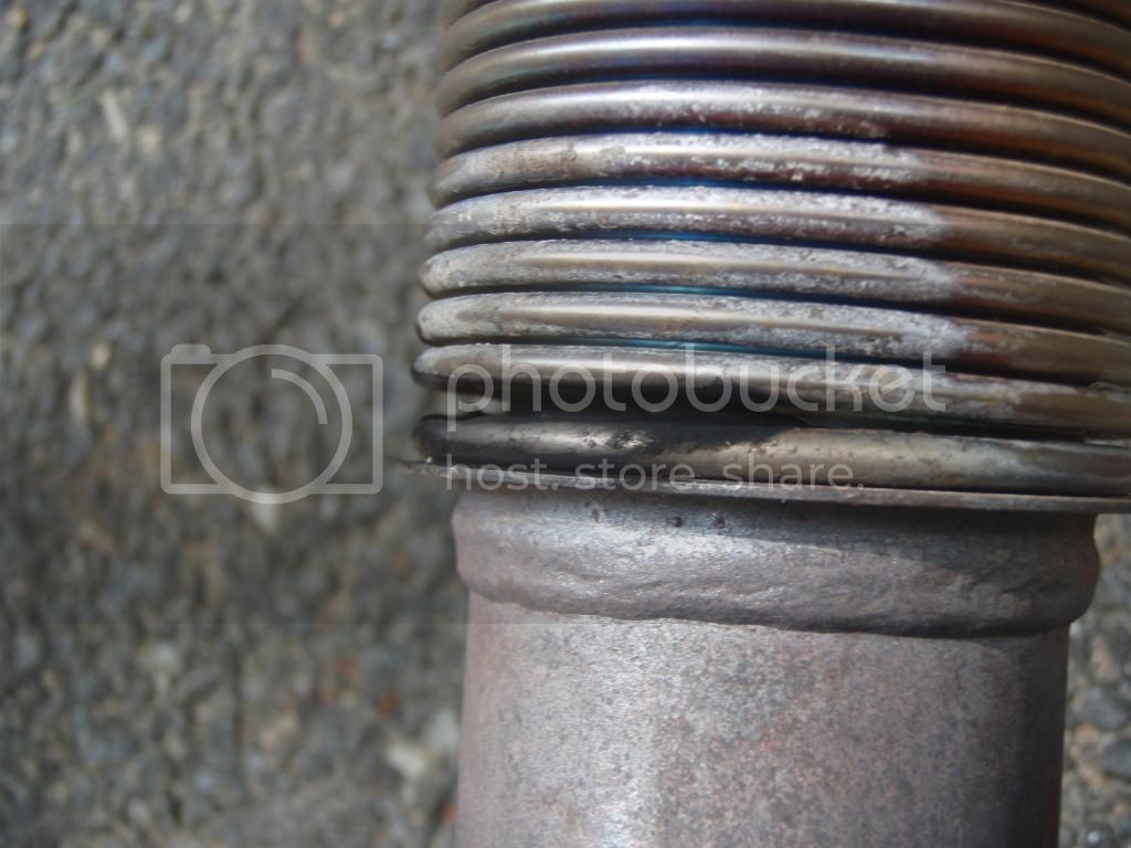

Had them on for about a week and half. Got them for $238. Seem to be a decent stock replacement. The SS bellows are big and have an interlock lining. I think the welds could have been a little better on the pipes though.

Not sure about any gains. The bellow on my stock y-pipe had been bad for a while and had to wait until I could afford a new one. Couldn't beat the deal on the MBRP. Good product for the money.
After installing the MBRP y-pipe it was so much nicer driving my truck. No more high pitched squeal, EGT's dropped back down to where they should be, more responsive and improved boost without the leak. Also I gained .5mpg.
This was my stock y-pipe:
Hit it with some high temp paint I had:
