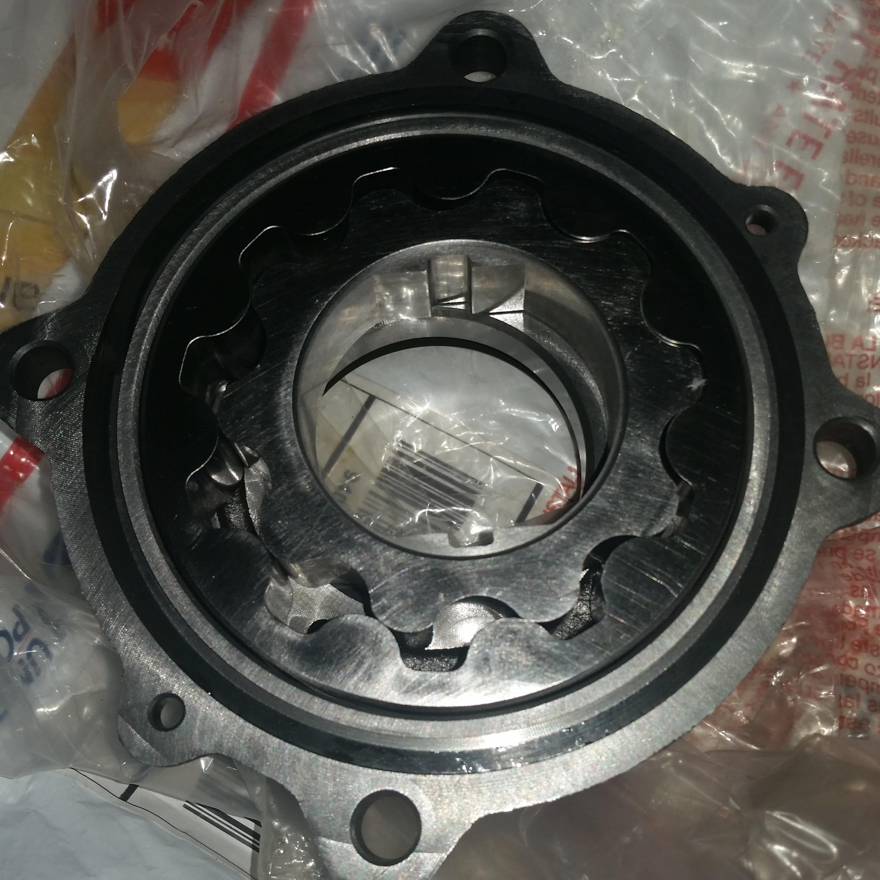

Well I ordered a lpop off the net. When it got here the package was beat to piss. To the point where the instructions with it are shredded. I'm looking at the gasket that replaced the orange factory o ring, it's square. But it is also cut but it's at an angle almost like it suppose to be. Does anyone know if it's suppose to be solid or cut? And what's better a new oring or this seal? Thanks

Here are some pictures of what I'm taking about.

Can you get the LPOP off without removing radiator/intercooler. I have a Melling and a leak so hopefully that is the cause of it.
Swaan
Mar 19, 2012
734
You have to pull the rad.
The pump is behind the harmonic balancer. To get the balancer off you need a puller. There's just not enough room with the rad in to do this.
Inter cooler can stay.
2000wa250
Oct 15, 2011
1,048
I've never had to pull the radiator to swap lpop....pull goes on, short inpact to get it loosened up, then use a wrench to pull it completely...
