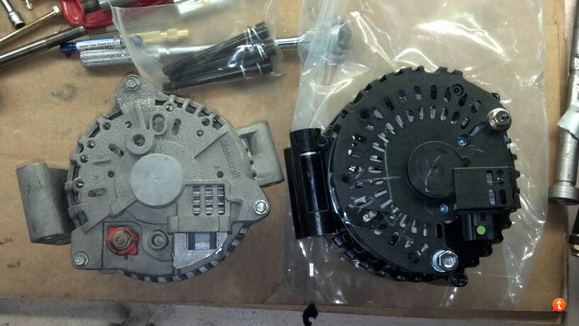

here is the new alt side by side with the "LARGE CASE" 250 amp upgrade alt. You can see how much more beef there is.
Yeah thats a lot larger. It is a external rectifier mounted on the exterior like the DC units? They claim it helps w/ heat management.
Any specs to share?
Is this of your design parameters/wish list?
ETA to market?

It is a Leece Neville in a custom case. All the diodes and regulator are on the back.
