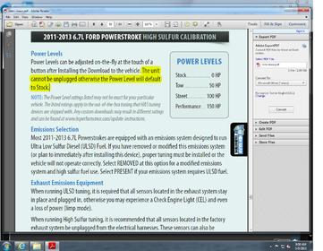

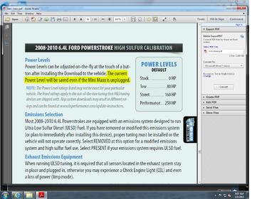

From the H&S manual; 6.4 saves the power level, 6.7 reverts back to stock power level

Yeah, I am guessing the confusion is related to what Eric said… The newer trucks turn back to stock, but the old 6.4's stay where they're supposed to.
