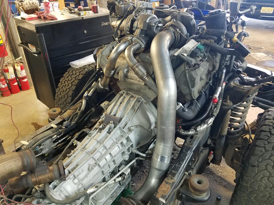

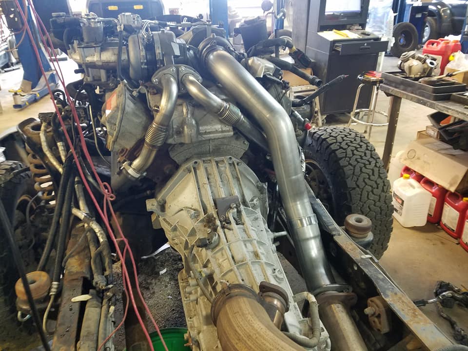

Some pics of the progress. Should have the truck rolling again soon.
