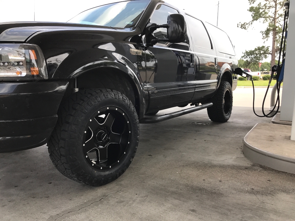

Ok has anyone drilled a new hole in their spring perch to relocate the axle?
I'm temped to do so after fighting my tires rubbing the back of front fender
and pinch weld.
Here is my post about getting the springs sorted out.
https://r.tapatalk.com/shareLink?sh.../forums/showthread.php?p=1391166&share_type=t
I broke down and bought some 20x10's wrapped in 295/60/20 Ridge Grapplers.
I thought going smaller than the 35's I had would clear. I was wrong.

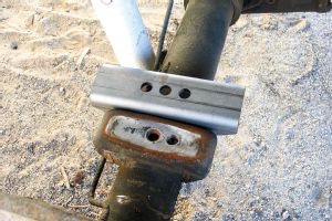

you could drill another hole in the spring pad like in the picture you posted that had the new weld on brackets

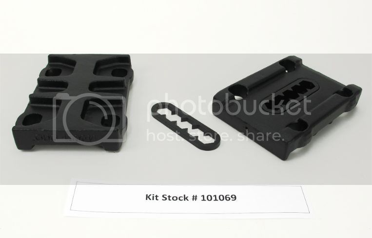

and make an offset top plate like PMF sells or buy the PMF unit ( so your still pulling everything together evenly )
the only risk i see is the potential to rotate the axle a bit but you Leafs are probably pretty flat

Here are some nice adjustable top plates for you...

Has anyone tried running something like what Zmann posted. Will it cause any problems. Looks like a simple solution, maybe too simple.
