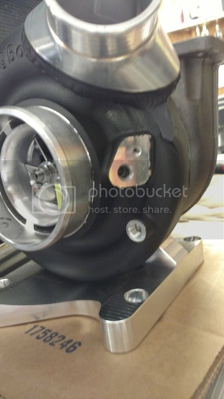

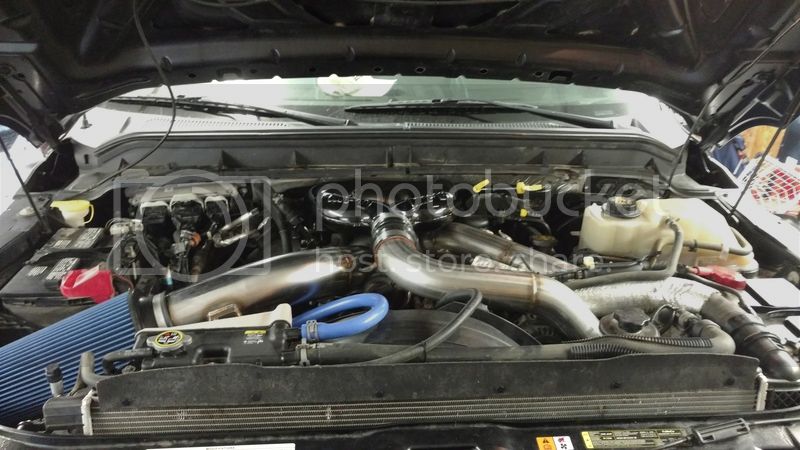

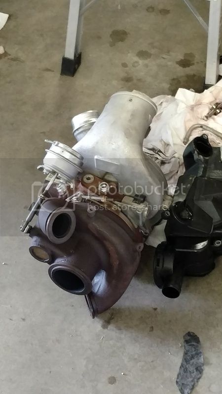

Couple pics from the install:
Got the monster out!
New 363 going in:
All finished up:
