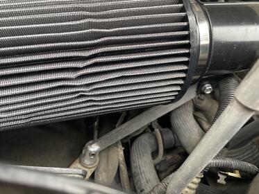

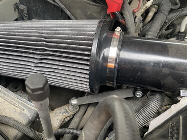

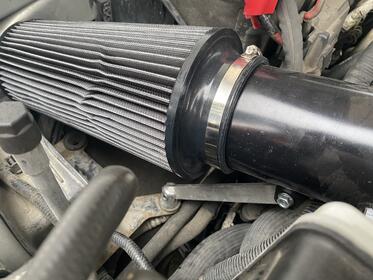

Lol you want me to get a picture of mine to help ya see how it goes in?

Here are the pics taken from a few angles hope this helps

Lol all good man,it just helps firm it up so it’s not so cantilevered off the intake manifold, if you still have it I would definitely put it on!
