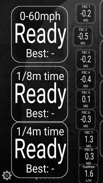

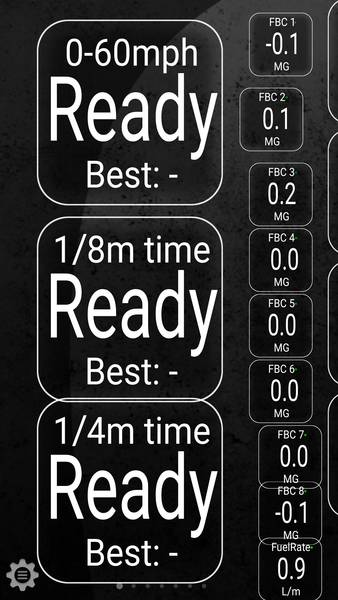

I had my torque app on this morning right after I cranked it and noticed my cyl 7 injector was at 1.3 and then after running for about 10 minutes it read 0 and the rest where also much closer. Is this a sign the injector is having an issue or just normal? It's a 188k mile 2011. The truck runs really good but I do notice right after I start it when it's cold and I try to just go it has a bit of sluggishness and sounds different. Then once it revs up a good time or two it kinda clears up and runs better. I do always use the remote start in the morning but after sitting all day and I get in it in the afternoon I've noticed it making the different sound and performance at first.
