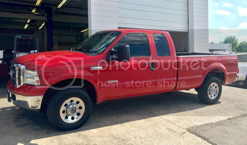

Figured I would start a little build thread to track my progress, in February 2014 I purchased this 2005 Extended cab long bed, 4x4, xlt, f250. The truck had 228,000 miles on it and was a work truck most of its life, so it needed some love.
Here is a picture when I purchased the truck

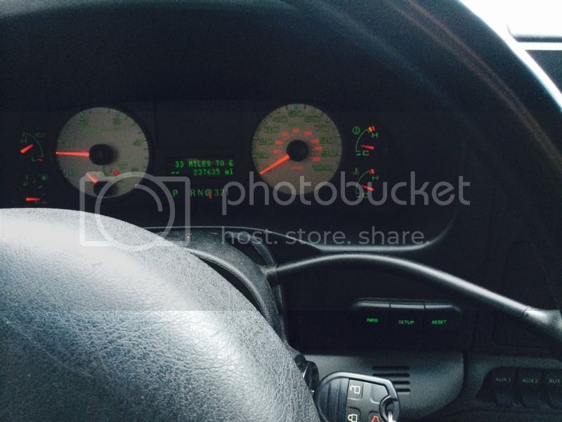

Wanted to change it a bit, so I went through the work of installing a lariat cluster, function buttons, compass module, and auto dimming mirror. At the same time I also cut the cover on the ignition cylinder so that I could use the 11+ keys, installed a factory brake controller, and upfitter switches.

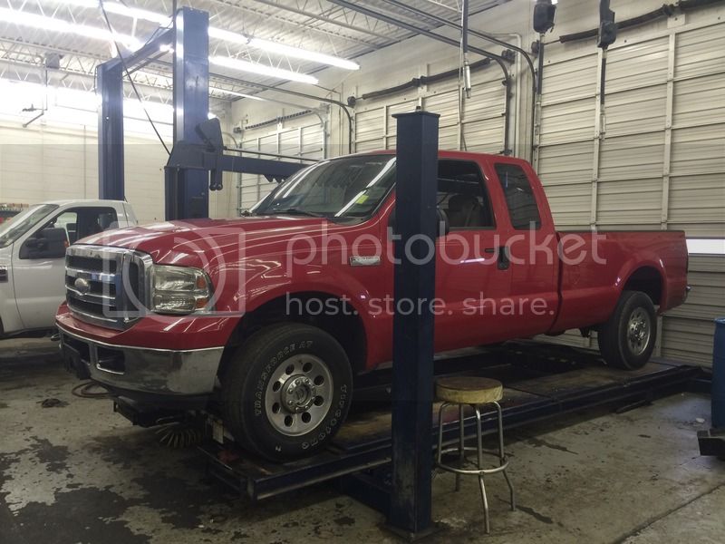

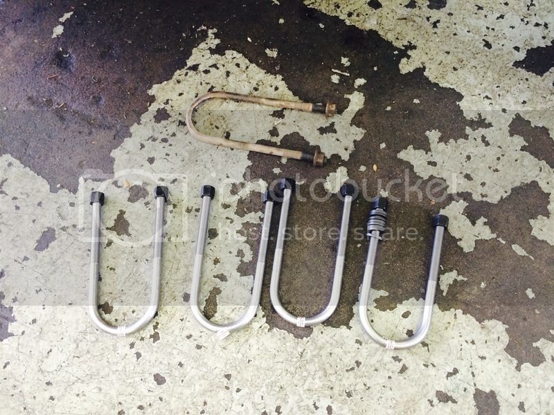

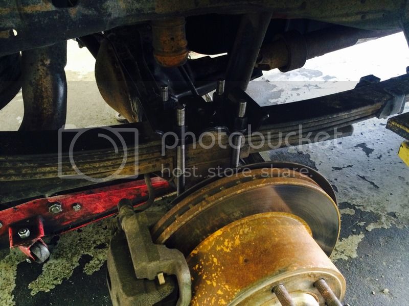

I wanted to level the truck by lowering the rear 2", so I had shorter ubolts made and removed the factory 2" block.
t9oHnv
tqRdNn

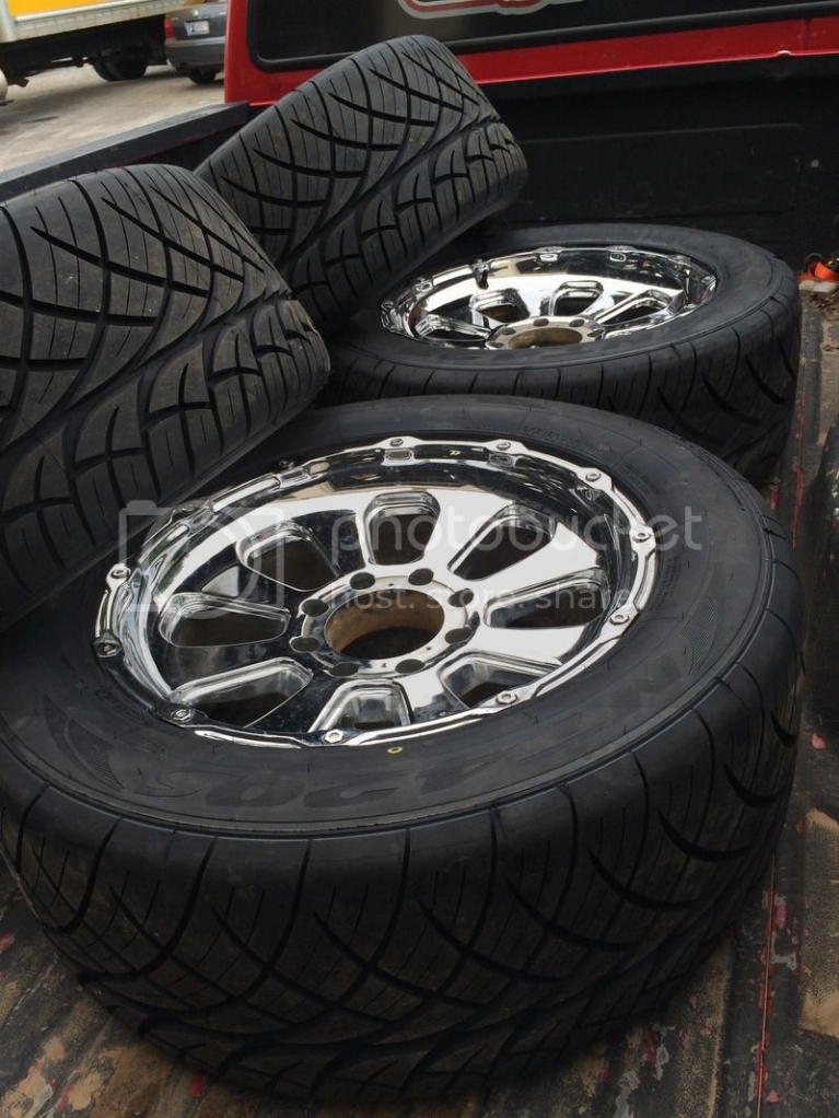

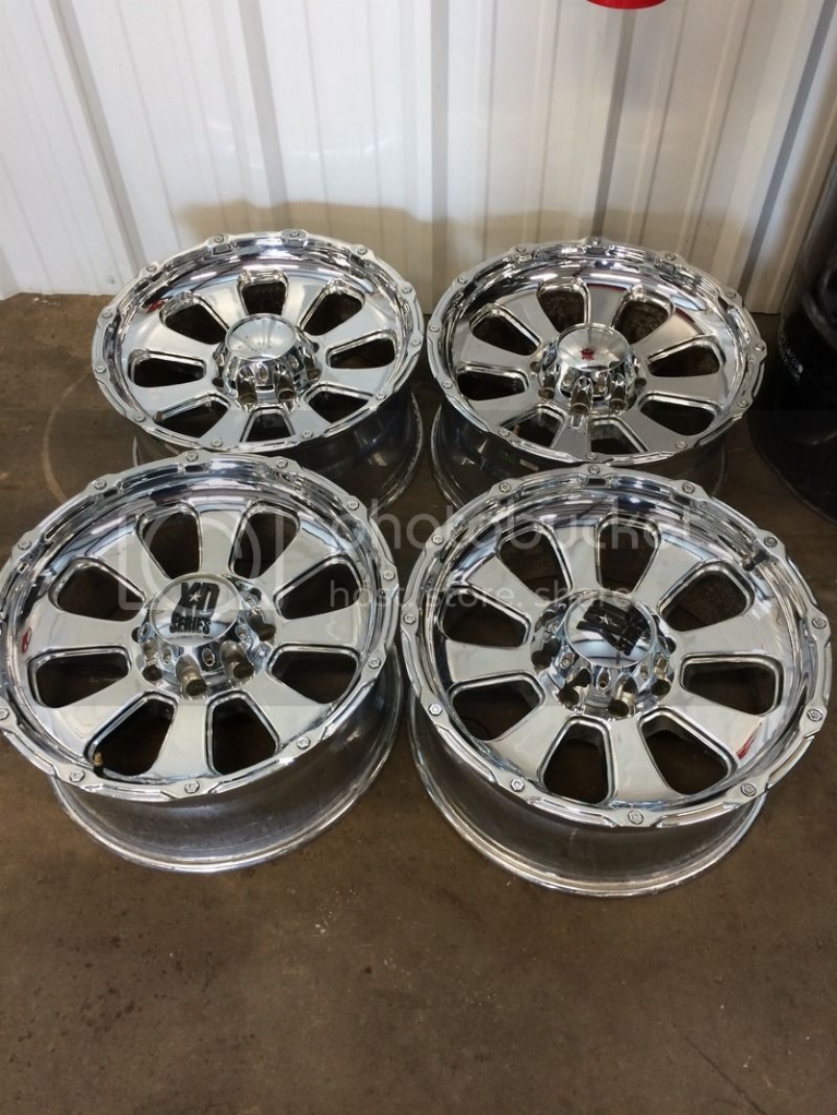

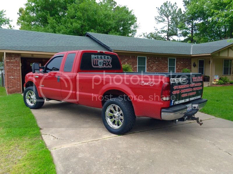

I had been wanting a set of wheels since I purchased the truck, but had been putting it off because of the cost. I happen to have a customer that wanted to trade this set of 20x9 KMC XD 799's for some work I did on his excursion. I wrapped them in 305/50/20 Nitto 420s
tqNLJH
t9mzPP
tqNPyv
t9m8tH
