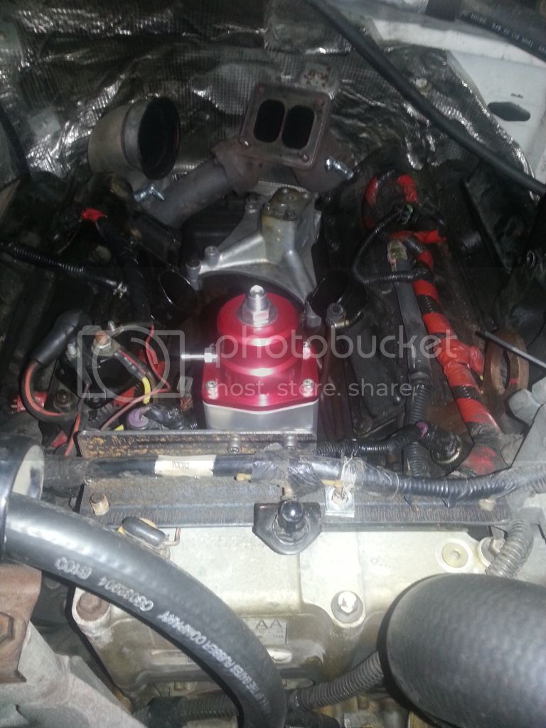

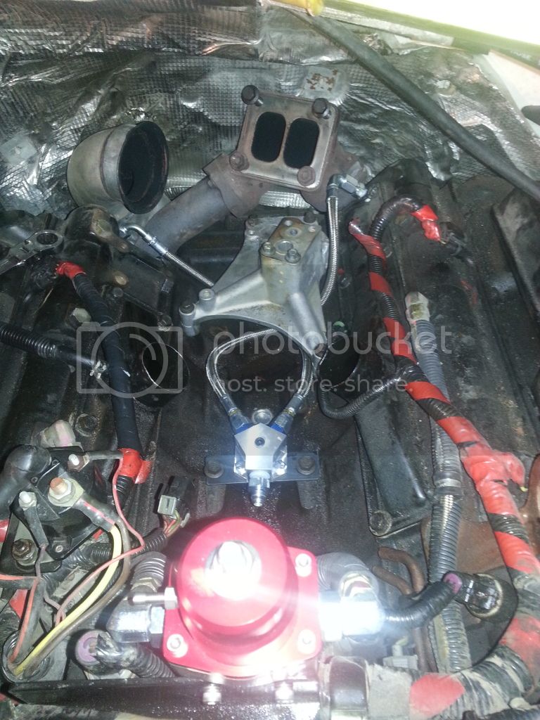

Here's my finalized list of parts I used.
Motor:
(2) -6 JIC X 1/8" NPT ( these go in the back of the heads )
(2) stainless braided Teflon inside hose 90* -6 on one end and a straight -6 on the other. Both about 1 foot long.
(1) Y from Summit. http://www.summitracing.com/parts/ear-100181erl
(1) aermotive regulator from Summit. http://www.summitracing.com/parts/aei-13109/overview/
(1) 1/8" NPT T
(1) 0-100 psi gauge
(3) 3/8 ORB x -4 JIC. these go on the regulator to attach the lines coming off the front of the heads and to the factory steel return line.
(1) 3/8 NPT x -6 pushloc 45*. This comes off the Y and hooks into the factory steel feed line.
Filter setup:
(2) Filterbases http://www.fleetfilter.com/filter/wix-filter-bases/24770.html
(1) superduty pump, bracket, and harness
(2) factory style quick connects for the pump. http://www.summitracing.com/parts/RNB-800-120/?rtype=10
(2) 1/2 NPT 90*
(4) 1/2 x 1/4" NPT Bushings
(4) 5/16" x 1/4" NPT Hose barbs

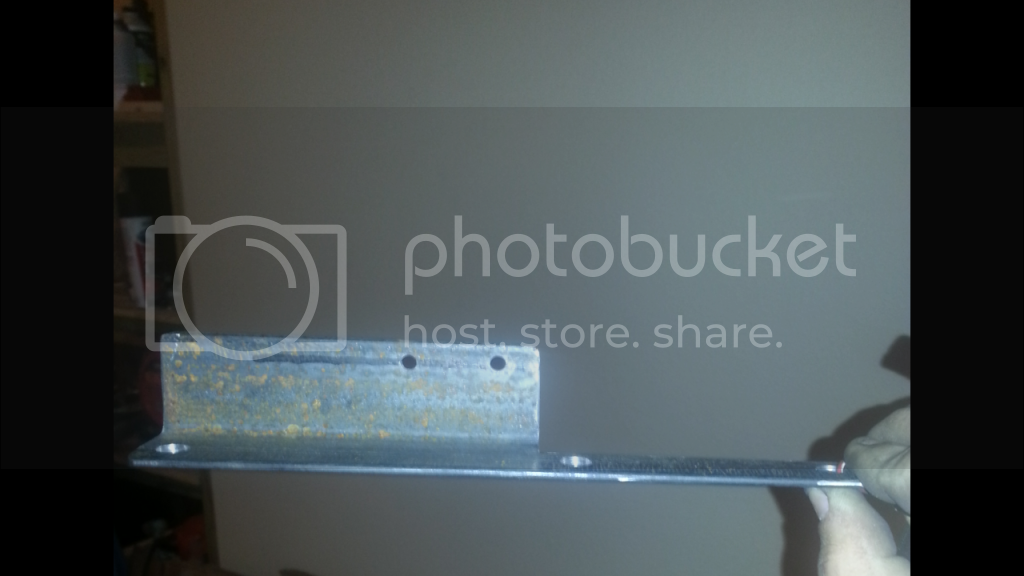

Some way to mount all of it. I made my own bracket out of 1/4" plate and 2x2x1/4" angle.
Hose:
1' of 3/8" pushloc. Needed for the Y to the factory feed line.
6' of 5/16" fuel rated hose. I used gates barricade. Needed for filter plumbing.
Also about 15-20 hose clamps.
I think that's about it. All my fittings came from the Parker store. Everything I ordered off line I added the links.
