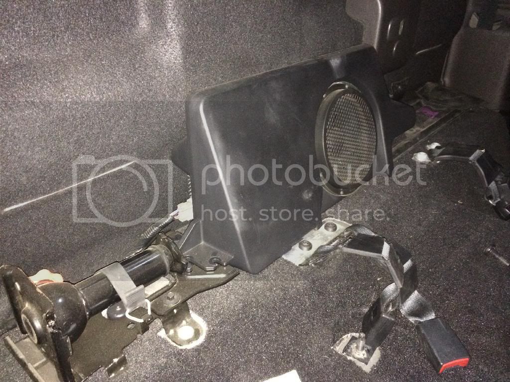

Here is the factory sub and box. The amp is tiny and mounted to the back of the box itself. Pretty slick deal, and works well for what it is. Like most of us here, I wanted just a little more without giving up the factory fit and finish of this set up though. (Don't mind the dust. lol)
I started by pulling the box out... It's 5 bolts and a plug. Super simple.

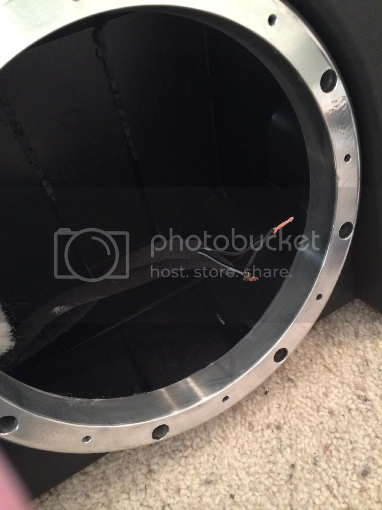

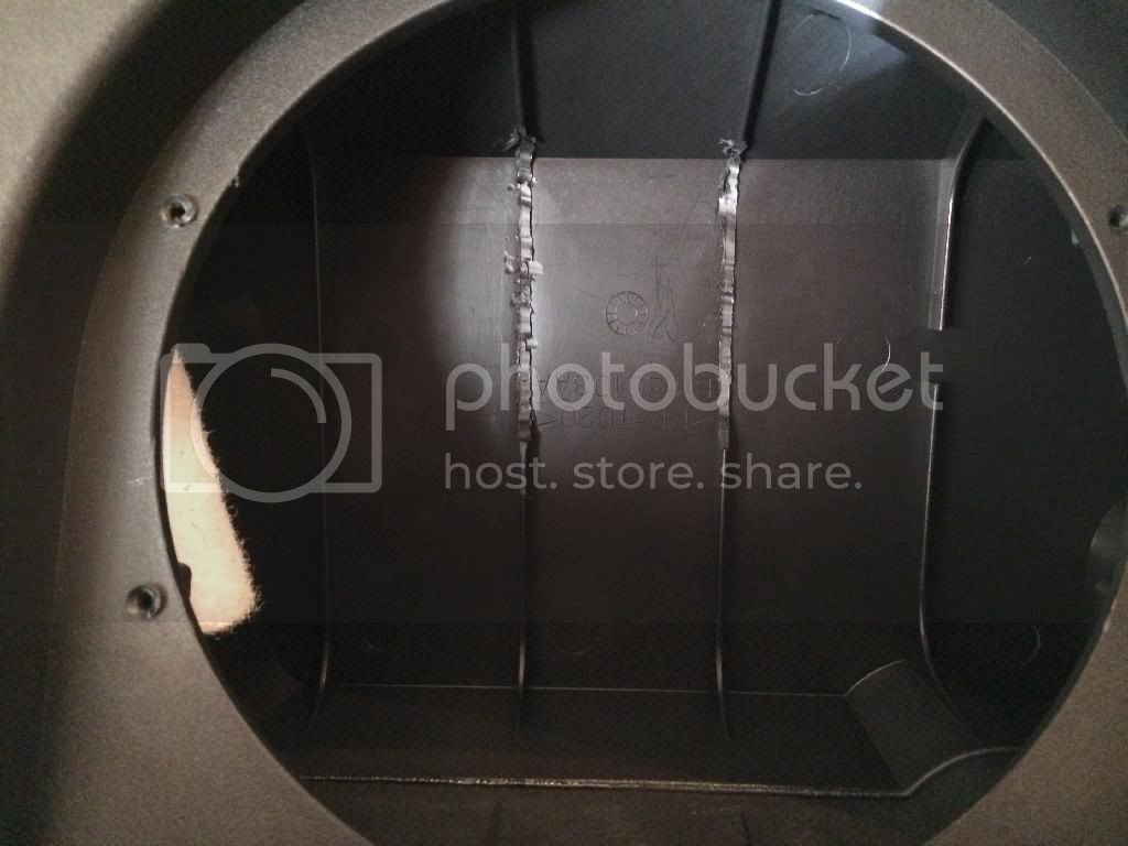

To adapt our new sub to the box, and provide some of the clearance that the deeper sub needs, we add this sweet billet ring, and take a dremel or whiz wheel to the ribs in the back of the box. Here you can see where I clearanced the ribs.
You use the stock torx bolts from the old sub to fasten it on. Also - use some ultra gray RTV or something similar between the ring and the box. The ring comes with new allen bolts to attach the sub to it.
Since the new sub doesn't use these plugs, and also only has 1 port for positive and negative, I twisted the two positives and negatives together.

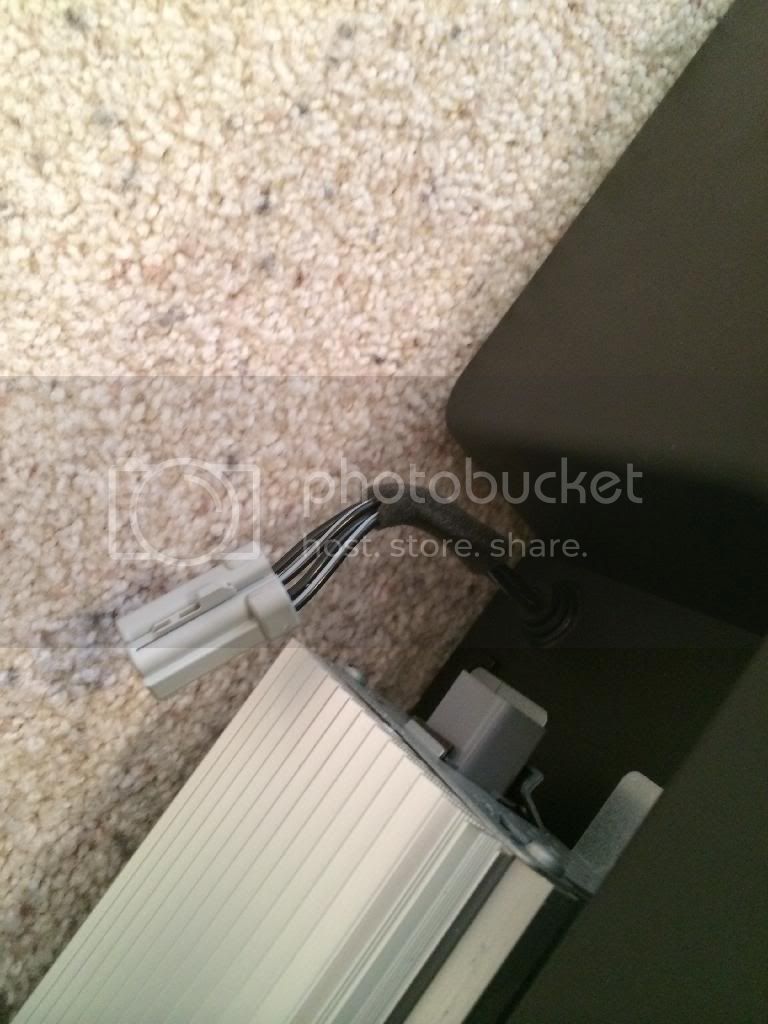

The stock box has a harness that exits through a grommet in the back. Here is a picture before I cut the plug off to splice to my speaker wire once it's in the truck. Don't forget to twist these two together if you twisted the other ends together. Two are marked with a white tracer to make things easier.

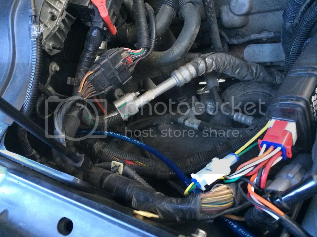

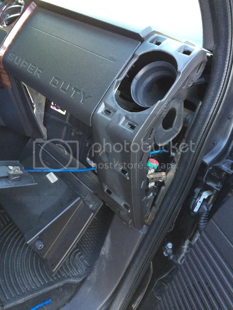

Now we are ready to wire the amp and everything else in! Starting with power, take the power lead from the battery and run it through the firewall. In my case, I went through the passenger side. It was a pain to find the wire I pushed through inside the cab. Look for the blue wire. It's hidden behind a bunch of junk. Also, now is a good time to stuff some sound barrier up onto the firewall. :D

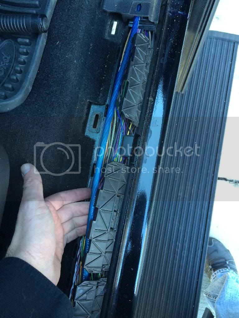

One thing that I really like about these trucks is the wire tray that runs the edge of the cab front to rear. Makes laying wire like this super simple.

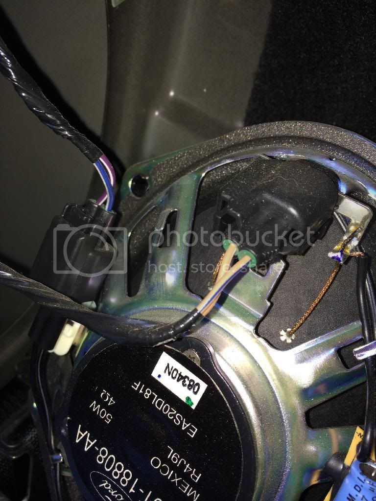

Now that we have power to the back, we will tackle getting our crossover wired in. The crossover is what is going to give our new sub a signal from the stock system. Luckily, we can take it from the speaker in the c pillar. In mine, the 2 orange wires are the signal that I needed. They are positive and negative; again the negative wire has the tracer.
Now, we have to wire these in to the corresponding inputs on our crossover. I also took this opportunity to add sound deadener to the C pillar! I mounted the crossover inside of the C pillar too. Now we can plug the RCA's into the crossover and leave them out to plug into the amp.

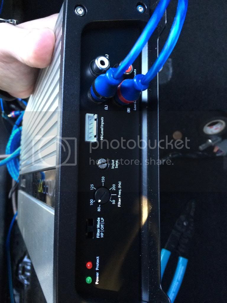

Pay close attention to the speaker wires on the amp. Notice that they are bridged. This essentially means that we are only using one channel of the available 2 channels on this amp. These wires are what you splice into the back of your sub box where we cut the plug off.
The very last thing is hooking up the RCA cables from the crossover to the amp and then tuning the amp. This sub runs best between 80 and 100hz. On the deck, turn the bass down and tune it to your liking!

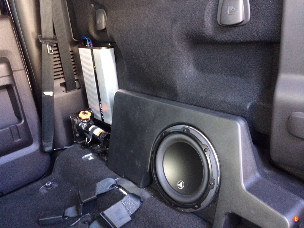

I have had this for a couple days now and it's AWESOME! It is perfect for guys looking for the next level from their stock sound systems. I need to make a bracket for mounting the amp, but I will worry about that this weekend!

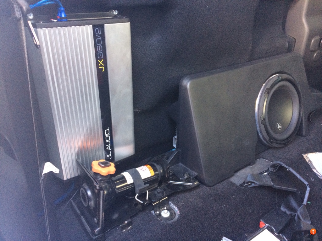

Nathannial and I got my amp mounted up yesterday. Thank you Nathannial for the idea! Looks great and I'm super happy with it.
A little update on the sub - I've been enjoying it more and more every time I get in the truck. I'm really glad I put this thing in!
