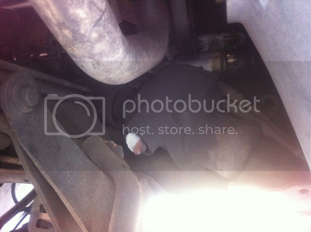

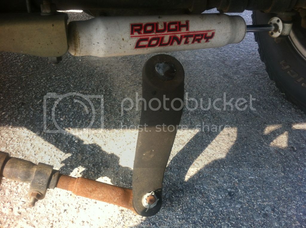

So last night my steering box snapped. I had to tow it to the shop today. What kind can I get that's better beefier, and tighter than that stock? What are my options??

mine snapped a few months ago too. friggin scary.
from what i can tell it was from stress and movement. bolts loosen over time which caused the issue. it is a common issue though

I've broke a few like that... There all the same, so getting a redhead will do nothing to prevent this failure...

Lift and big tires... It happens.
Common, I dont think so, but it happens. Most times at low speeds while trying to turn a heavy tire. Once your moving there is not near the TQ load on the box as when your trying to turn and not moving.

90% of the time this is isolated to 99-04 boxes. They beefed up that shaft on 05up trucks.
