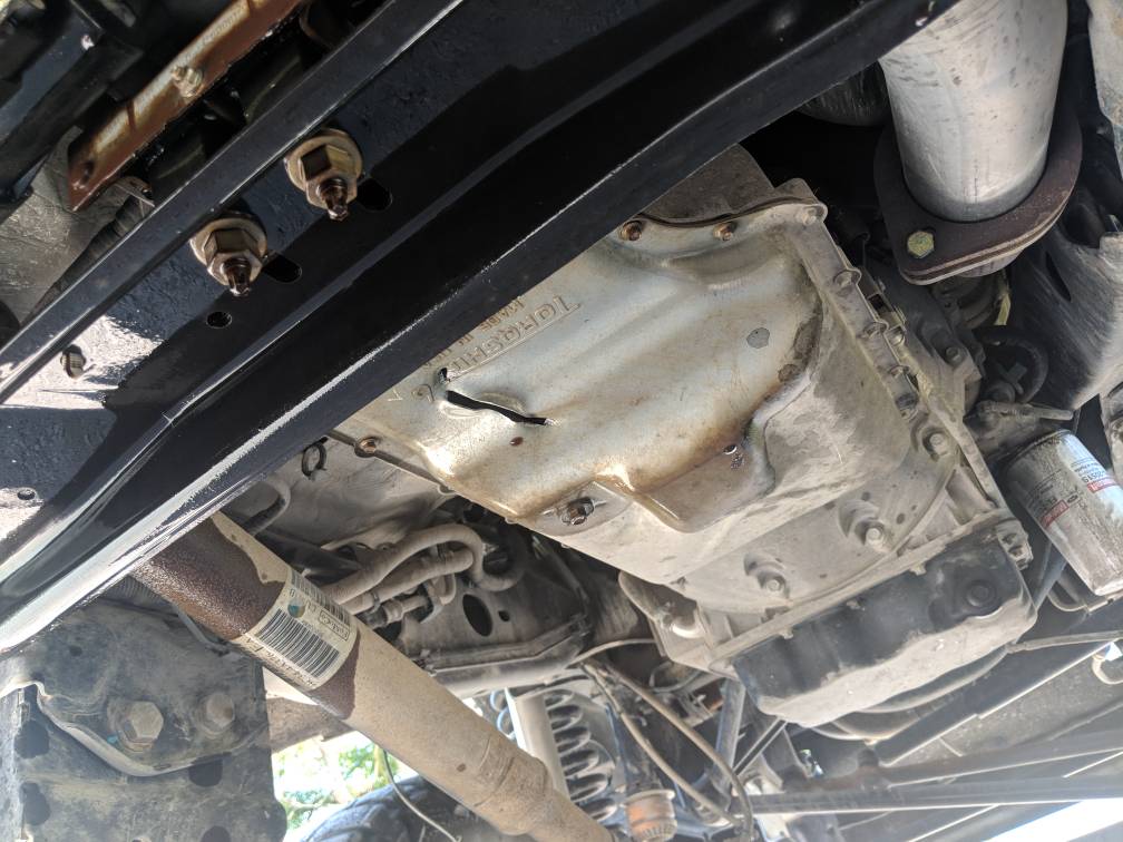

So today driving something must have flew up and took out my transmission pan. It's got a big 4" cut in it. Lost all fluid while driving. FML [emoji34][emoji34][emoji34]!!!

Here it is

Looks to me like metal is pushed in like something punctured it. Would like to know what is was with you that high off the ground

Why not put a new pan on and fill it and see how it is? May have stopped moving cause you're out of fluid

Pull the pan and see if it looks good, metal free by good. If it looks good then by God get to it. By all means go buy a heavy aluminum pan with fins so it bounces off next time. Install the pan and top off the transmission. I would have 12 quarts on hand because torque converter is only place full .
Start truck in idle run shifter through all the gears keep pouring in until full. Then see how she does.
I don’t think you are gonna have any problems, like Mint6.0 stated you lost your fluid. No fluid no hydraulic pressure for any control.

Yep, trans needs oil to work the TC. Low on oil and they cant transfer the power. New
pan and fluid and it will probably be fine.

put a pan and oil in it. if it runs like $hit call me ! i'll get you taken care of, we sell midwest, elite and suncoast !

So after the pan and fluid the 3-4,4-5 shifts under throttle blow through it. Under normal low throttle driving it's ok. At first I thought I escaped without any damage.
