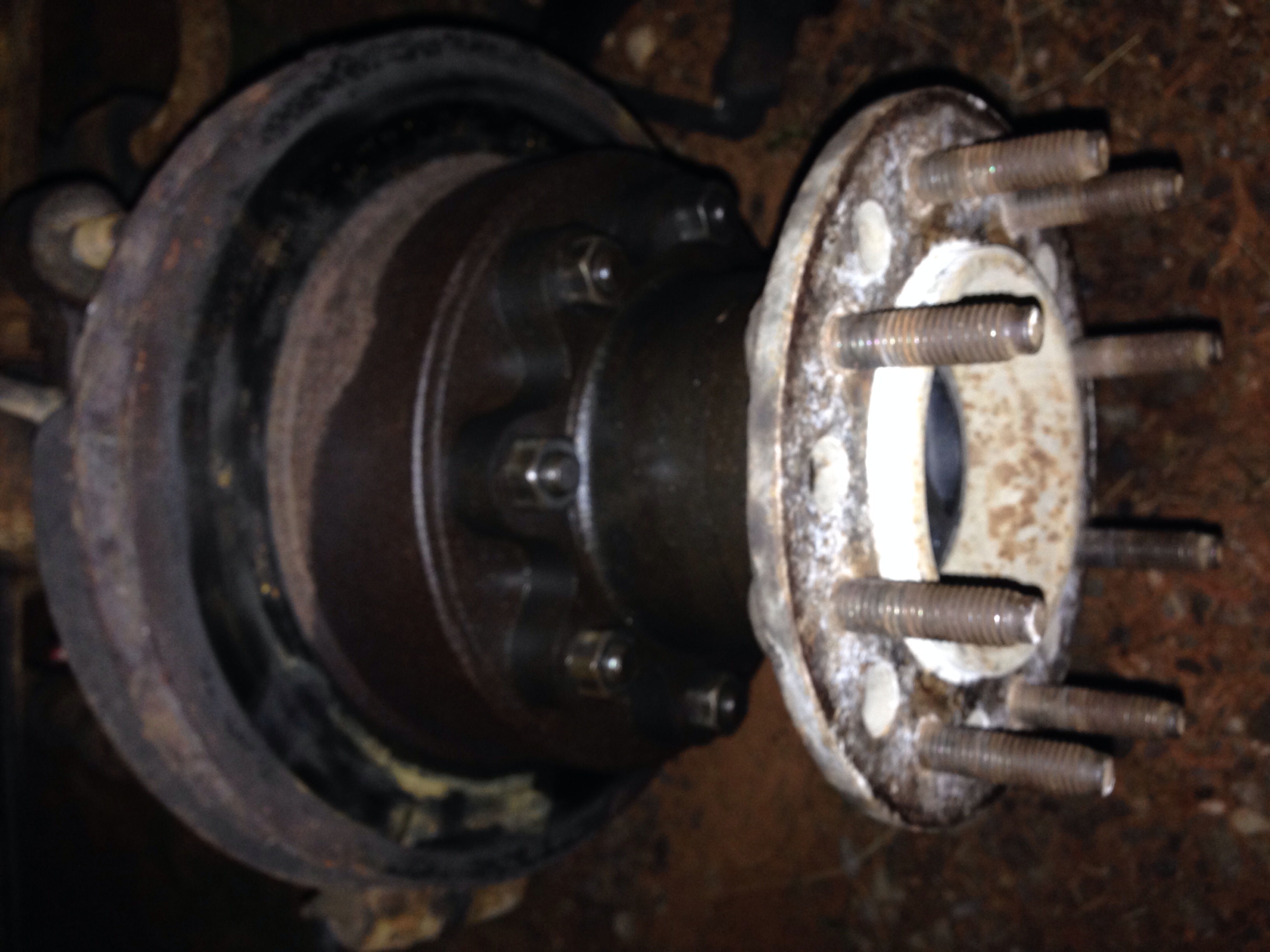

Need help on dual rear wheel break job!!
[QUOTE="Atsah, post: 849642, member: 186"] When I did mine, I used a mini sledge on the stud and hit the sledge with another hammer, put the lug nuts on first just even with the end of the stud. About 3 good hits on each one, was all it took. Putting them back in, big pin punch and drive them back in. Didn't peen over any of the ends or flatten the end of the lug nuts either. They can be a PITA to get out but this will work for ya.. [/QUOTE]
