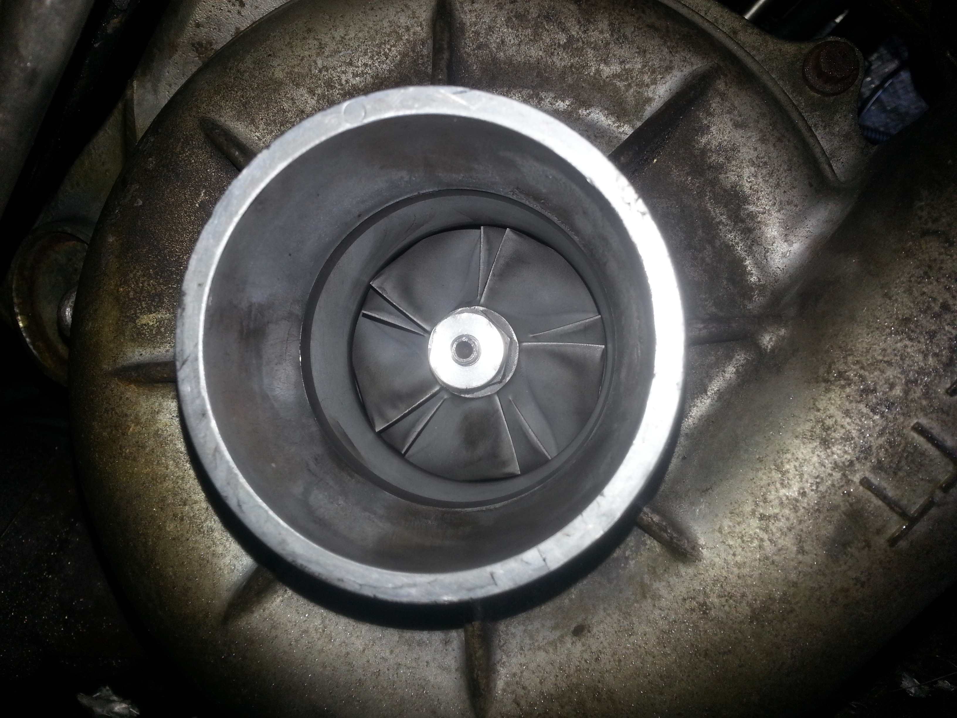

XrayPipeliner
Feb 19, 2013
87
Just looked the turbo over and everything seems fine. Spins freely and no in and out play.
