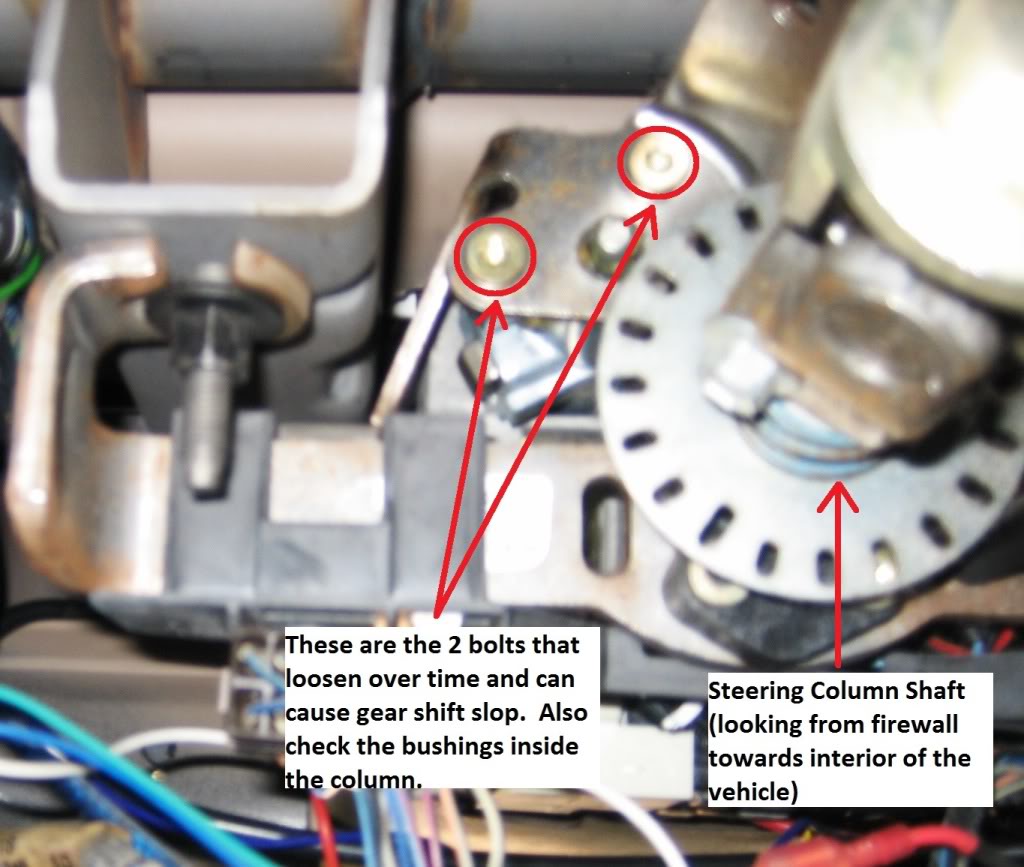

Is your shifter nice and firm tight between gears? Or is it a little sloppy?
Commonly the torx screw on the shifter linkage are notorious for loosening up.
If it is sloppy remove fuse panel, look up under dash(laying in floor) for these torx, and see if you can tighten them...
