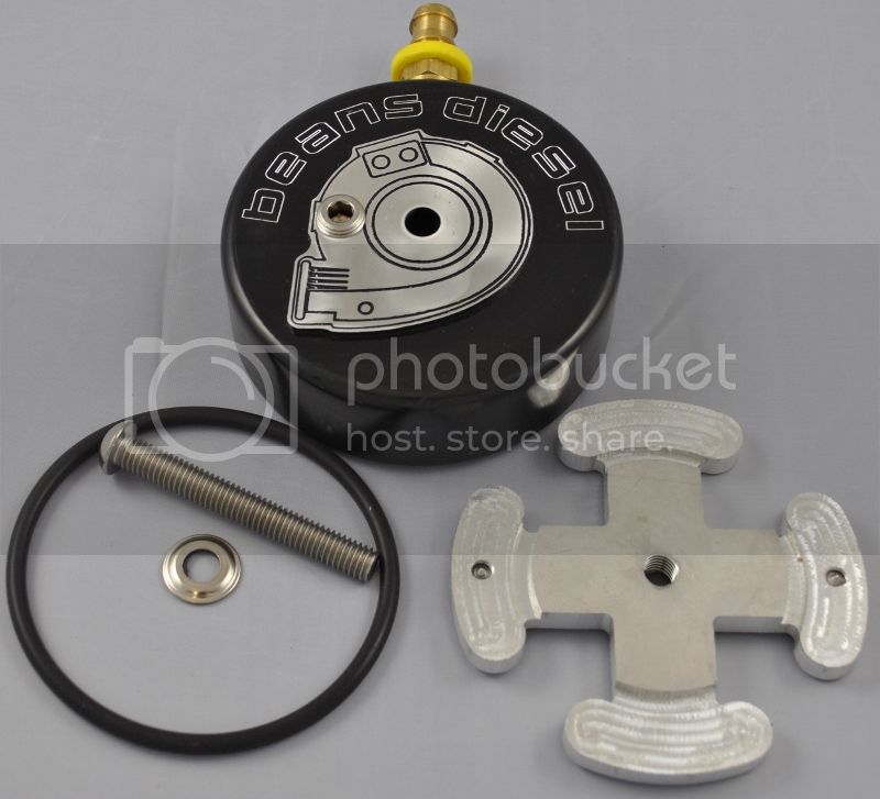

Here are some updated pictures with the final pieces.
Like i said earlier every sump will include the 3" hole saw for installation.
Should be up on the website in the next week or so.
Pricing will be the same as the old sumps normal price at $140

That's sweet! Any good way to adapt this to the stock sd fuel pump? And just leave the stock return and everything else the same? I would just rather do this sump instead of doing all the intake mods like hutch, ect.....

Yeah, they can be used on anything really. Just new line from the sump, to the pre pump filter.

anyone know if it fits between the tank and skid plate on an fx4 ?
or the dimensions of the sump?

Just got mine..... it's about 4-1/4" across and 1-3/4 tall. As to if it will fit between the skid plate and tank, I don't have one so..... I think it will with some modification.

im looking at how it attaches, and looks like it will attach with out dropping the tank, my air dog line will run rite to it, though im not sold on that one screw, is that a crush washer to stop the screw from backing out ?
If ya have one, please fill us in, im wondering about security of attacment against that 4 footed backing plate.

I'm interested as well. I have a fx4 with the skid and will it fit between? Also what hose from my airdog goes to the sump? And only one screw hold it?
