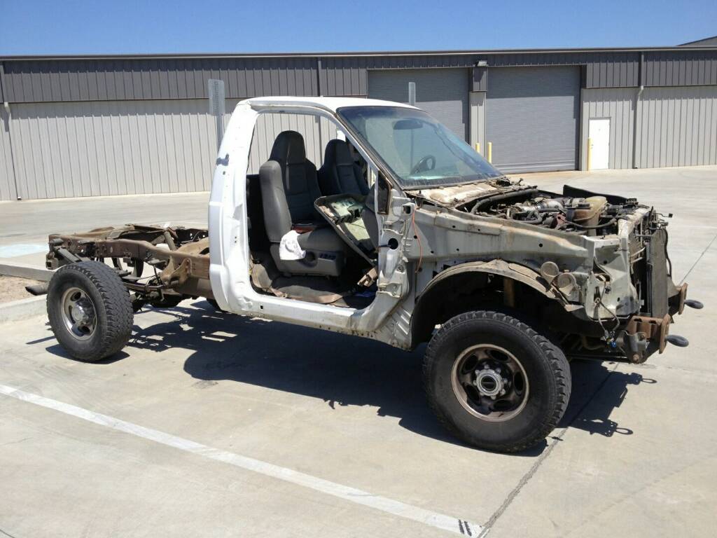

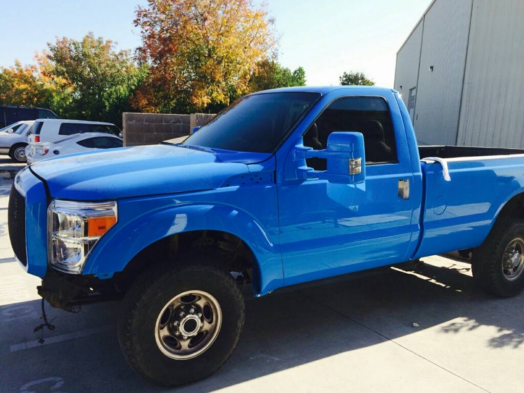

Just thought I'd share my new project with you. Can't seem to leave anything alone. Started life with me as a $500 99 F250 with a bad cylinder and is going to be my new daily driver.

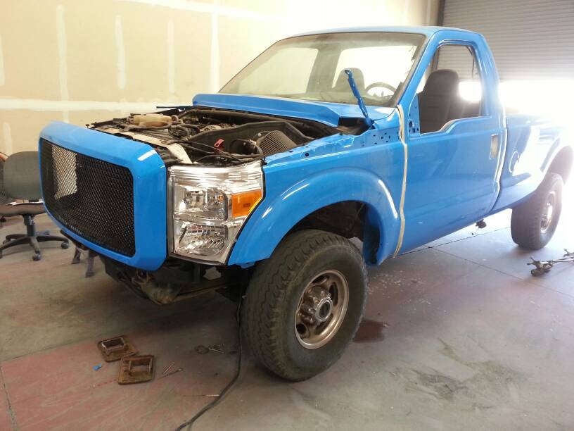

The seats are 06 lariat 40/20/40. It's 2013 grabber blue from the mustang. I the front end conversion is being shot for truckin mag and they wanted a before and it looked better blue than 3 different shades of spray paint white. The conversion is an almost bolt on kit being developed. More pic and info to come soon

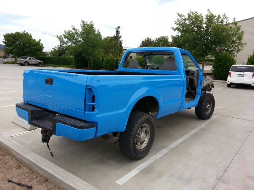

The plan right now is to use 11+ fender flares to hide the rear. Originally it was getting an 08 front end is why I used thay bed. I have an 11 bed available to me if the flares don't work out for me

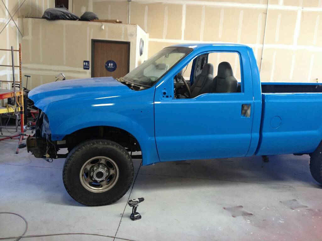

A couple more pics of it at paint and an interior shot of the wiring harness replacement. Went from an xl to full power interior

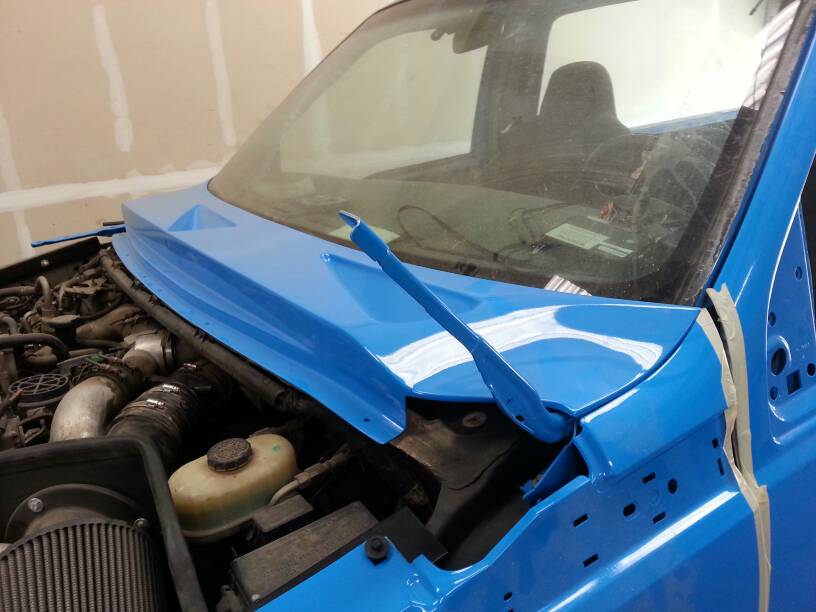

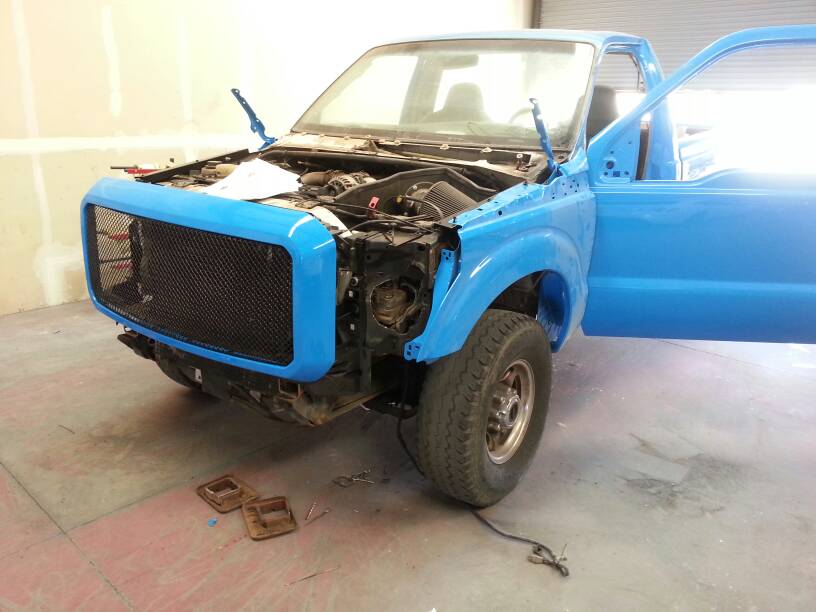

One of the pieces I have been waiting on. Fiberglass wiper cowl as the oem setup does not fit remotely close to the older trucks or have a way to fasten. All smooth for a more custom look as well

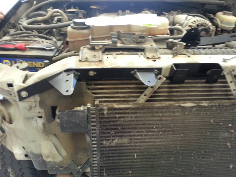

It's just sitting there loose but the best pic I have of the fender adaptor bracket

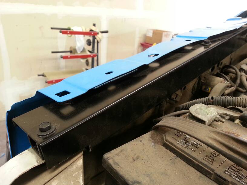

Upper grill and hood latch adaptor parts
