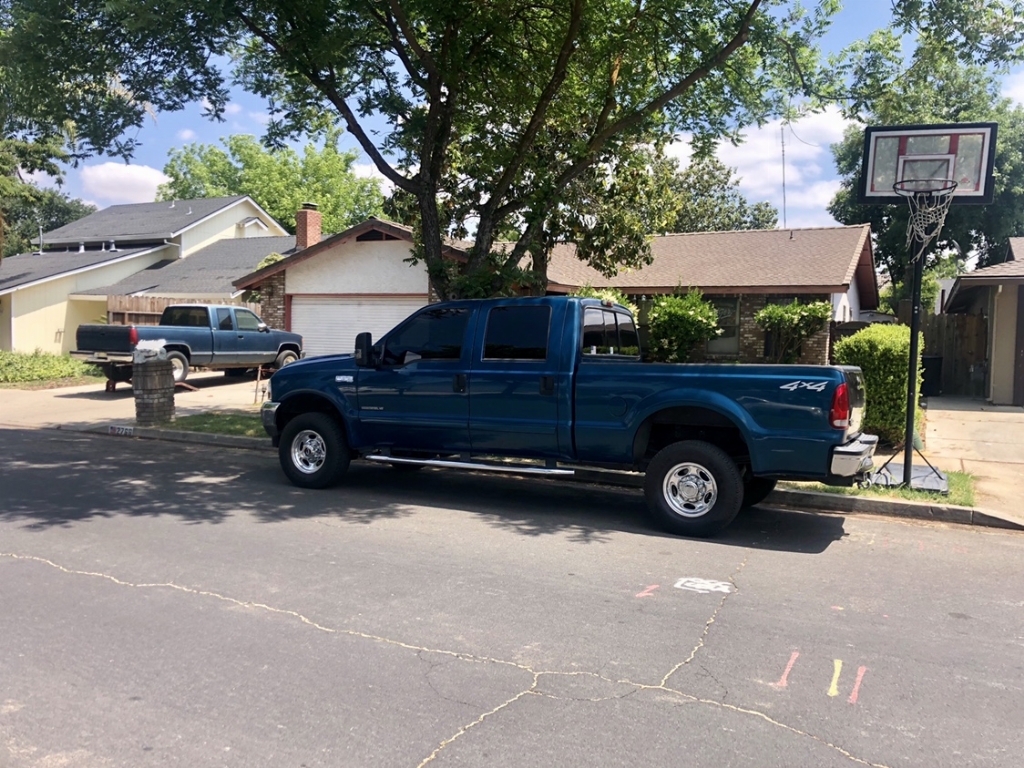

Hey guys, my names Chris. Just bought a 02 7.3 f350 with 142 on the odometer. First diesel for me, but I am a mechanic for John Deere so diesel knowledge isn’t new for me. It’s in relatively good shape drivetrain wise, needs paint and a driver seat cover. I’m gonna take it today to a local guy for an estimate on what the paint is gonna cost. It’s got a full turbo back MBRP kit on it. New batteries, water pump, and thermostats, as well has a few steering/suspension components. It’s Dark teal metallic, paint code R2.
I have a company truck so this is going to be primarily a tow rig / weekend driver. Im sure I’ll get some crap for it but I’m pretty sure I want to do the 17+ style mirrors for it and when it’s painted all the plastics will be done as well. Plans are to get a CTS2 monitor, tint and level. Truck has no oil anywhere on it nor does it look freshly cleaned. That being said does anyone have or point me in the direction of this color truck paint matched
