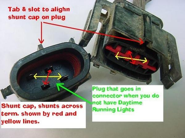

1.unplug the DRL module on my truck and take what most guys are calling a jumper plug,****** cap,shunting cap etc.from a truck car or suv of the same era as my truck and just simply plug it in to my harness that's going to my DRL module.

So number 3 made the most sense to me since no one had a pic of the jumper plug that needs to be taken of of a truck or car of the same era. Or a part # so I cut the wire and then plug the harness back in and there's no running lights but now I also have no head lights my turn signals and parking lights work and when I pull the turn signal lever to me my high beams go on but other than that no headlights! Any suggestions on how to get my headlights back?

The module is on the driver side near the radiator, iirc.
Should only have to unplug it, and that's it.
The non Canadian trucks have the harness and everything, just no module plugged in. No jumper I've seen. Just try to unplug it.

After some reading, you're right.
If you want I'm going to the junk yard tomorrow and can pull a jumper. I'll trade you for your drl module.
