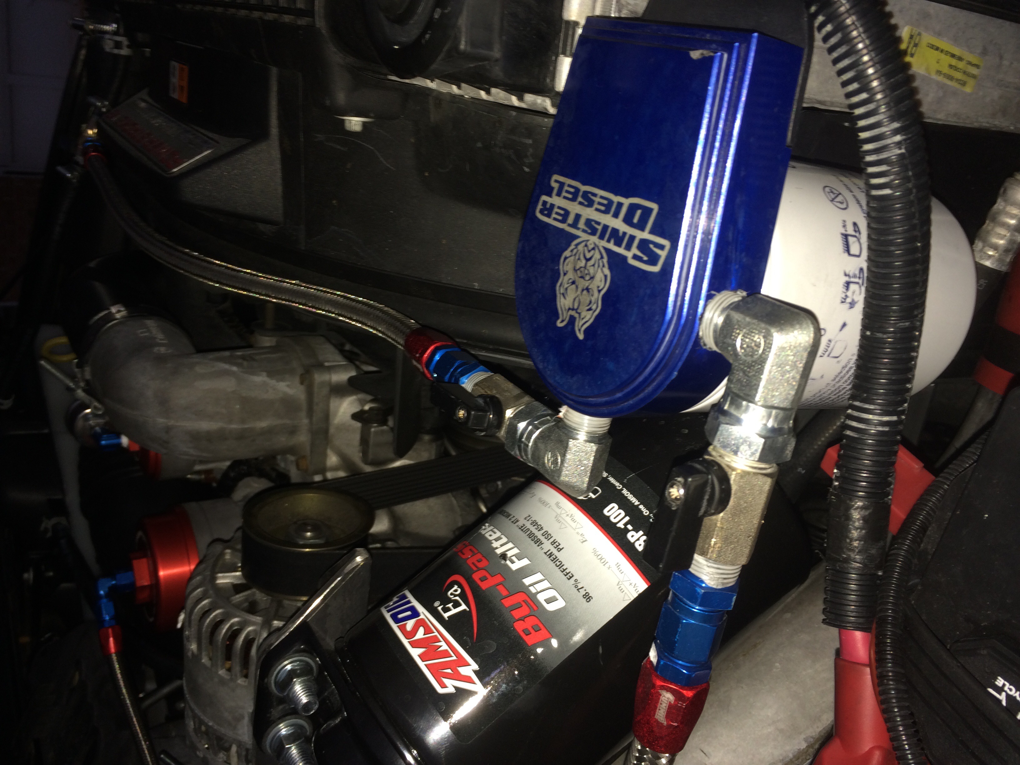

Hey guys new to the forum. I recently installed my oil/coolant bypass that I put together and it turned out great. I used summit an fittings and bulletproof diesels cap set. I fabbed up a bracket for coolant bypass and just used the sinister kit and left that where it was. Let me know what you guys think....

Bulletproof caps $227.00
Summit racing fittings and hoses $100
1- 1/8 npt to 4 an 90 degree swivel
4- 4 an hose ends
2- 1/8 npt to 4 an 45 degree
10ft- 4 an ss braided line " only need like 6ft though"
Amsoil filter base and filter $50.00
I could have done it cheaper with hydraulic fittings but I liked the red blue scheme.. I actually have 90 degree hydraulic fitting on there that I got from mcmastercarr for $5.00 and they are really nice. They are running to the coolant filter head

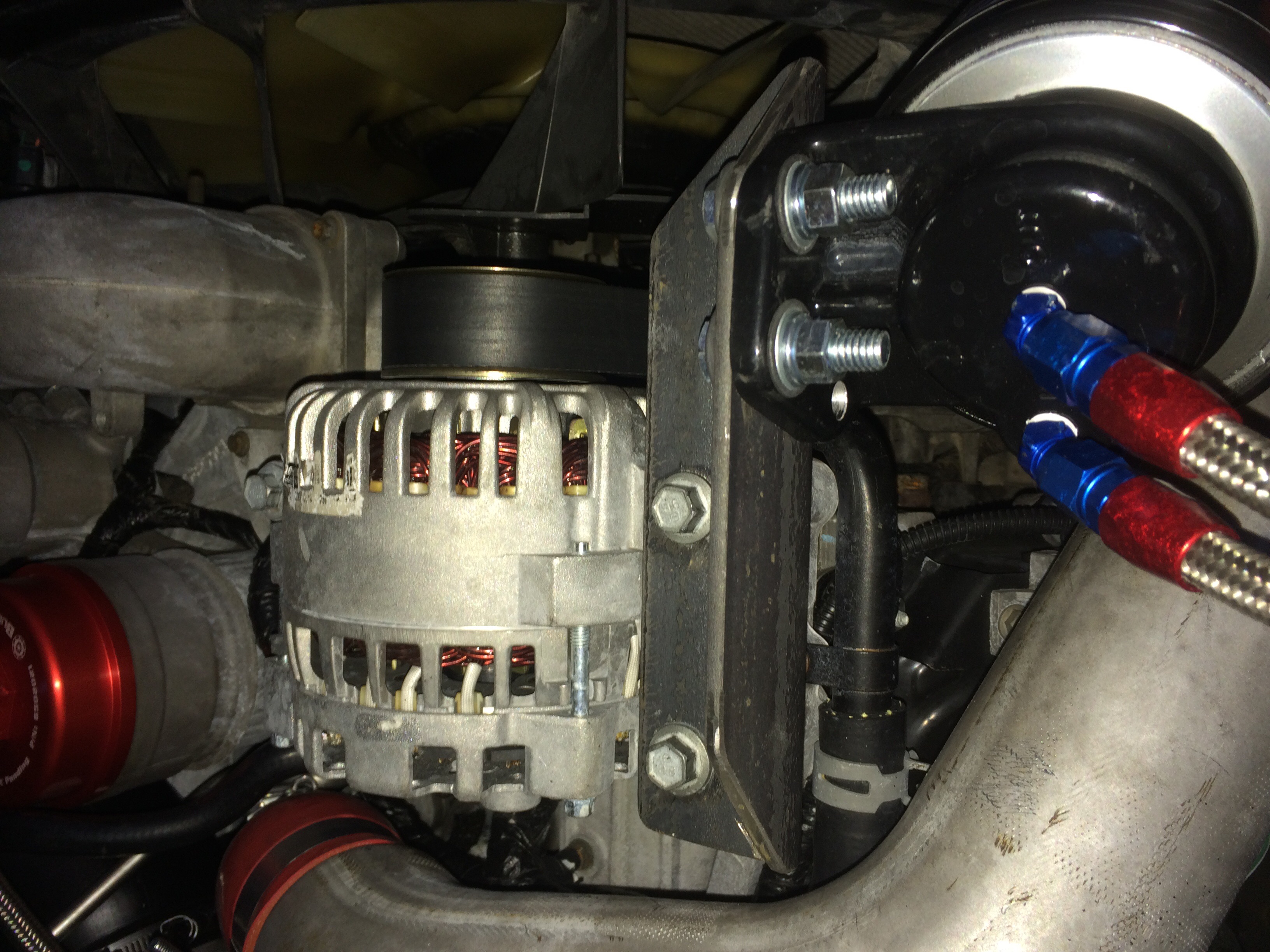

Here is some more close ups of bypass its a 2006 6.0 by the way with 149,000 it was fairly simple. I'm pretty picky on things. It probably took me about 2 hrs to install. Metal bracket came from Home Depot and I cut it down and angled it so when I'm in there working on it I don't get anymore injuries.

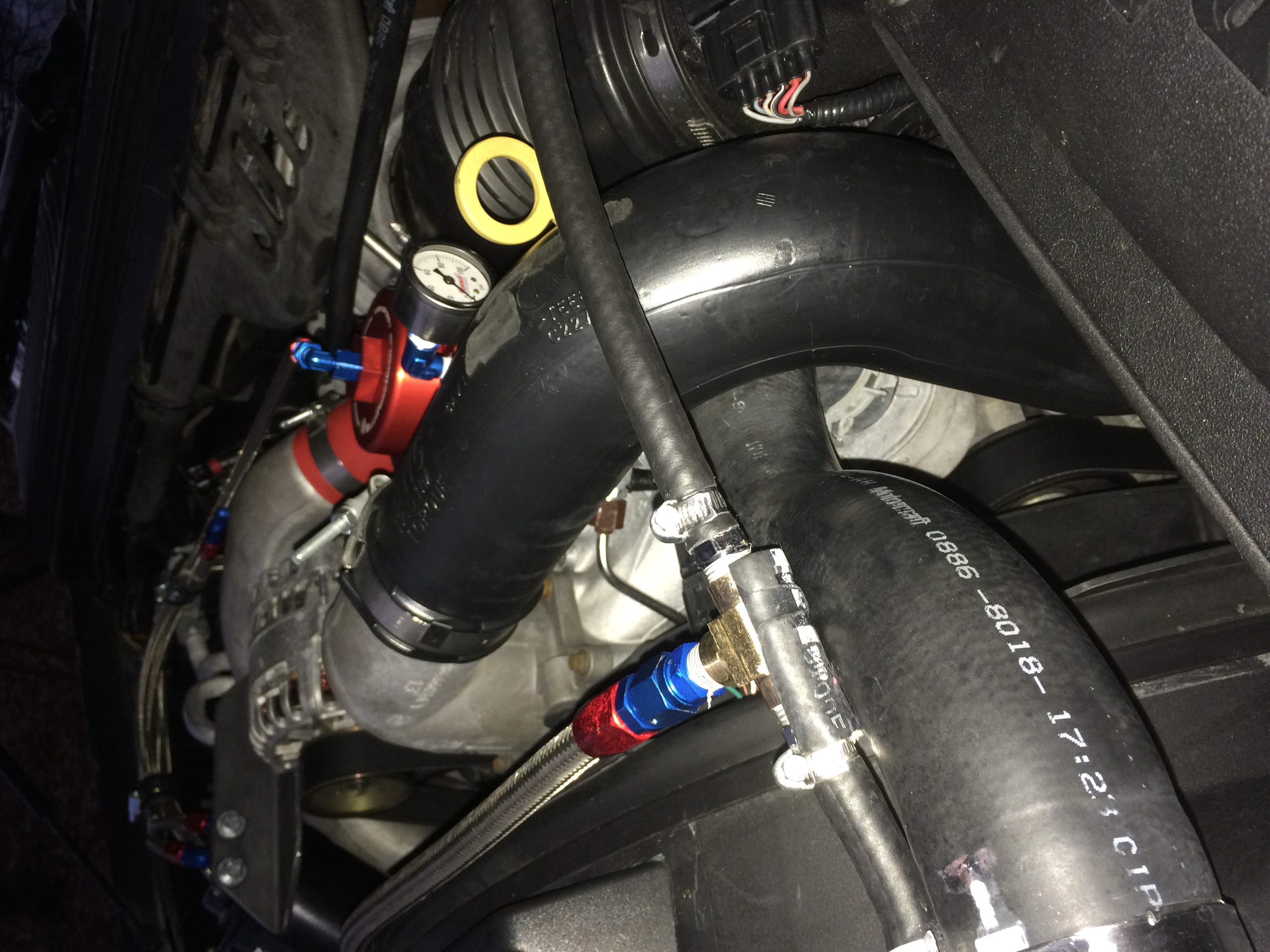

Coolant bypass running to tee in degas bottle through filter then to heater core hose

Tee at degas bottle and fuel filter housing with pressure gauge
